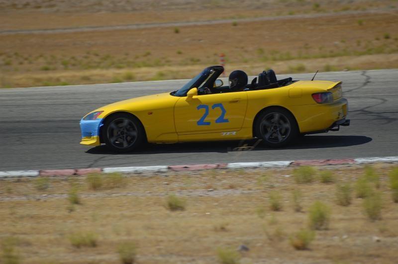

Then enjoy driving WAY over the speed limit without getting a ticket. Mods will come later when they'll make sense to you. For example and for those who knows, after some serious "floating" at turn 8 Big Willow, I decided to upgrade to a wing
My first time, Newb alert
Blue tape, top down, miles away from the Apex but having the time of my life...
