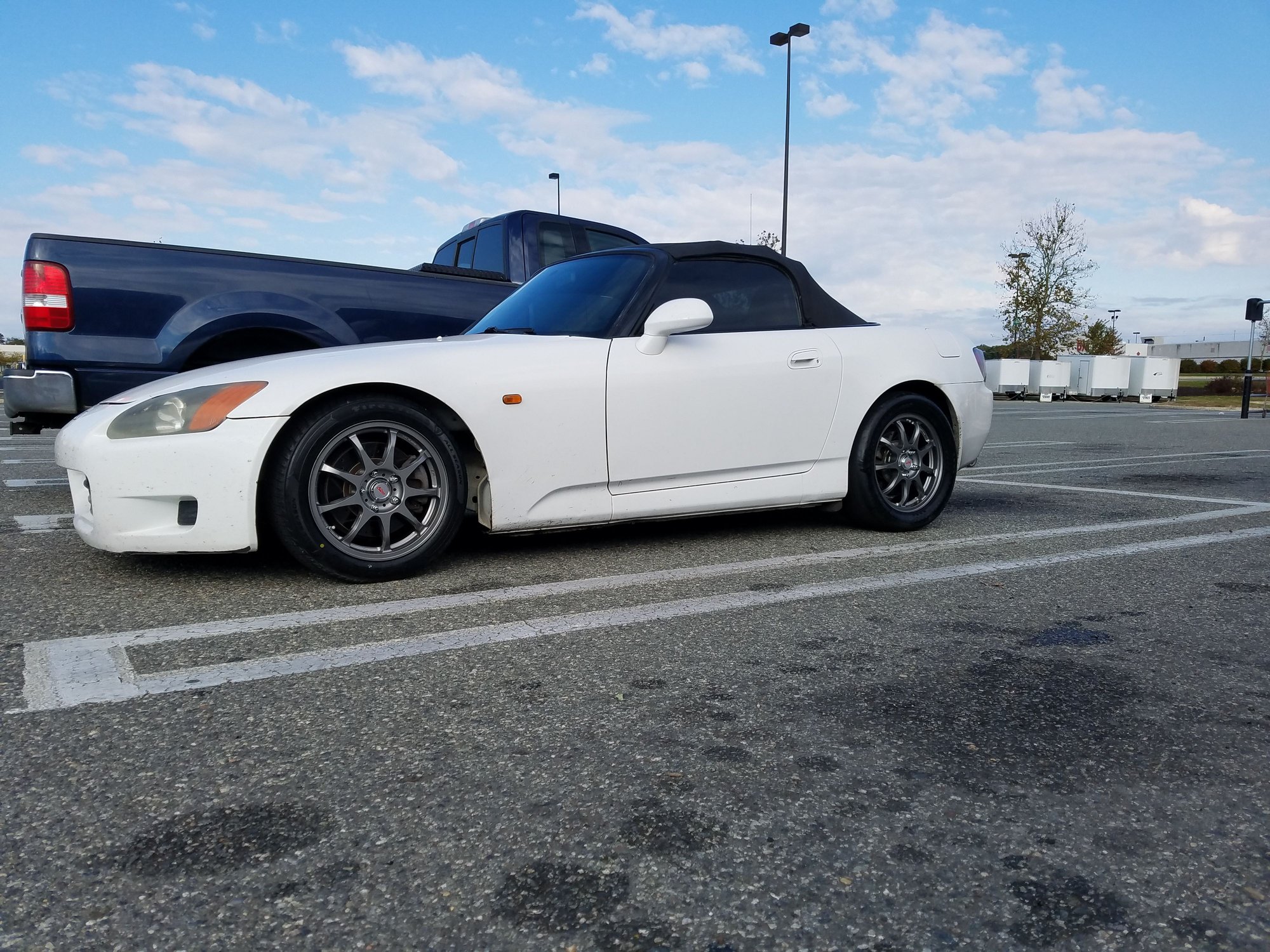

Sorry, the car is filthy in this pic lol.
I went with Kosei k4r 16x6.5 52mm offset on all 4 corners.
185 55 16 street tires up front
225 50 16 Hoosier Dr's out back
Total Weight savings according to my bathroom scale- 40lb.
Besides the weight savings, they tuck inside the wheelwells nicely. I would imagine there is an aerodynamic benefit as well. (Less tire sticking out past the fenders/bumpers).

Nice, I've been looking into "affordable" skinnies, no luck
