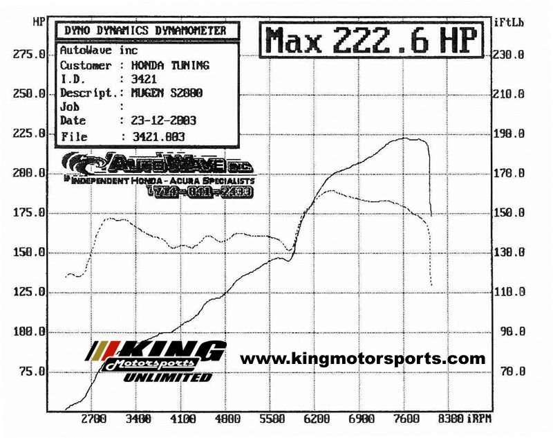

KingMotorsports 2004 S2000 with Mugen I/H/E
Check the main page of their site for more info. KingMotorsports

Very interesting numbers...too bad we know nothing else about how that Dyno was generated. I'd to see before and after dyno plots too.
