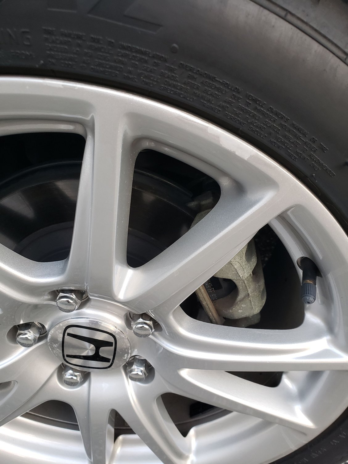

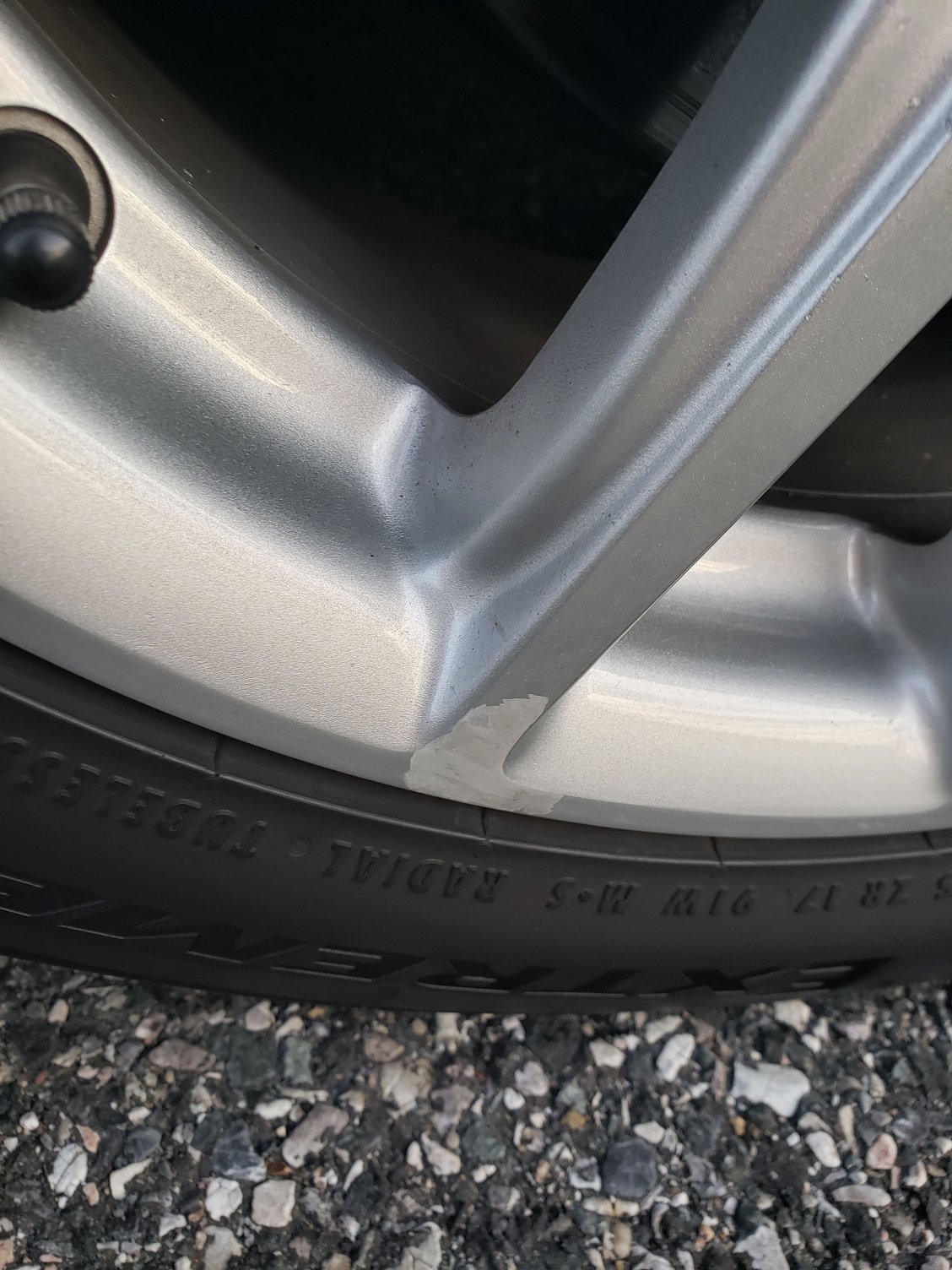

So winter is finally over in Maryland which means the S2000 can come out of the garage.
Just took it out yesterday and noticed that 3 out of the 4 wheels have some amount of wheel peeling. It was not like this last year when it went into storage and it never saw winter so I have no idea how this happened. It was even covered in the garage.
Has anyone experienced this? If so, was there a particular cause or is it just old age?
Also, does anyone have any idea on what the costs should/would be to fix these?

Humidity and road salt probably.
My wife's winter wheels peeled while sitting in the garage all summer. I don't think I ever cleaned the salt from them.
This winter, it looked like they were recovering from sunburn.

oh yeah 100% salt and weather related.
Age maybe but I bought a set of oem a 2004 Ap2V1 wheels last summer and they are mint condition. Storing them properly is everything. Same goes for tires.
My oem civic Si rims are flaking and and chipping like crazy. they were driven all year round in Toronto so the roads just ate them away.

Ya I could understand the salt and weather having an affect if this car ever saw winter.
But the fact that this car was garaged in October and came out in March is really irritating. Salt has never been on these rims

Hate to break it to you, but those have been refinished at some point. The OEM AP2 wheel has a machined face, those are all painted.

I wouldn't powder coat them.
Something got on them to cause pitting. Or the clear coat is faulty.
If you do fix them, make sure they remove all the dead clear coat or it will bubble up again.
