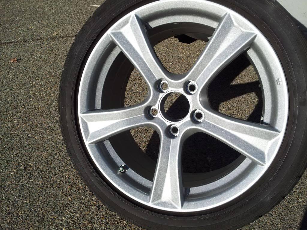

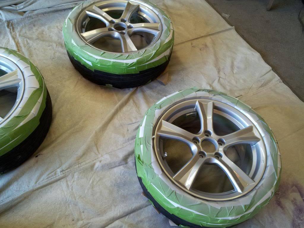

I have used good old Dupli Color for my wheels. I did it twice, there is a learning curve. I have been pretty happy and will do it again if need be. Pics below. The secret is good prep, proper temps, good technique and MULTIPLE clear coats. IMO at least 5 clear coats.
I did not have and still do not have one iota of curb rash. Benefits of not having to park all the time in a city. I did not have to do any metal refinishing but it is not hard to do either.

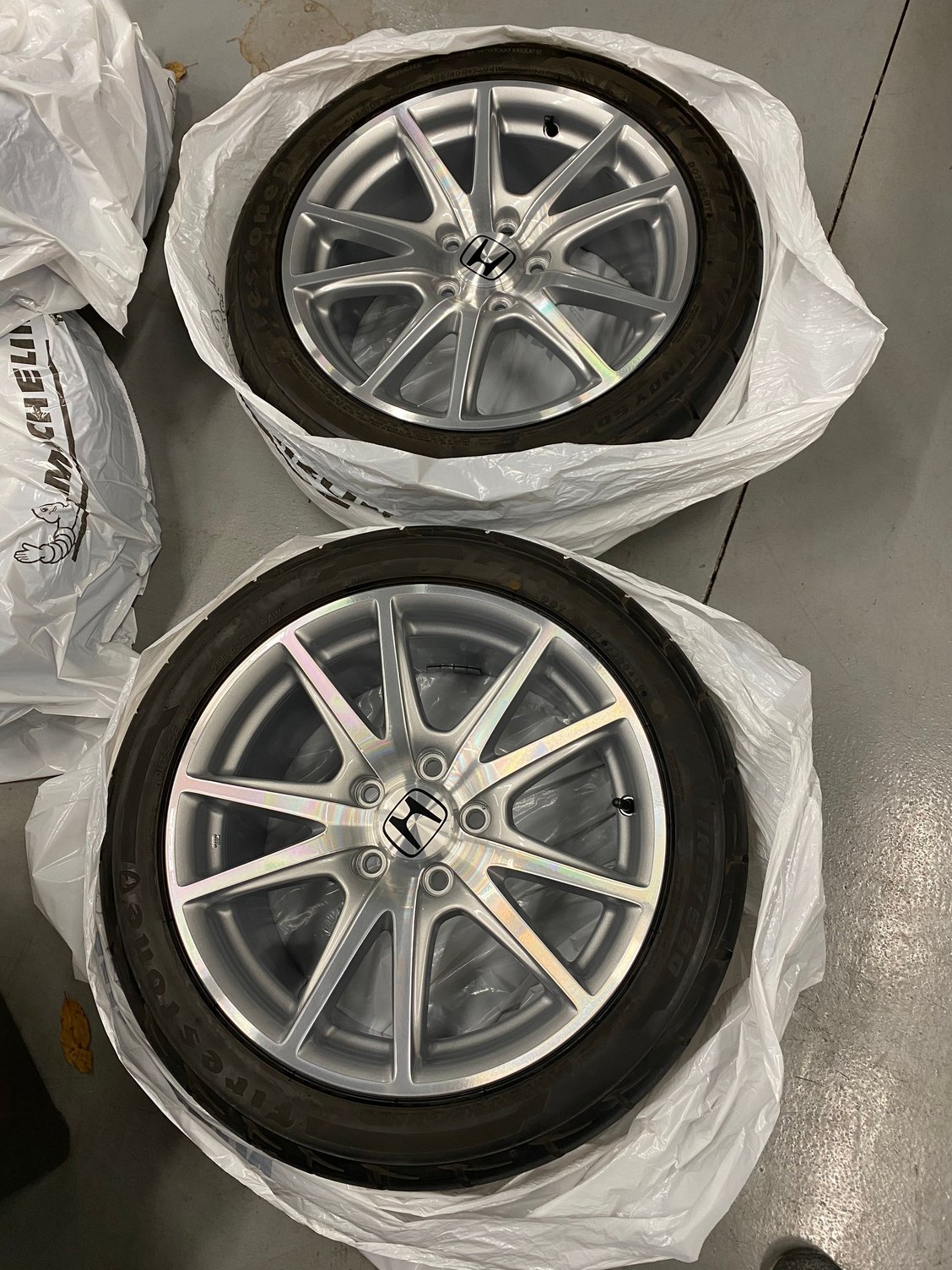

Those have definitely been painted. OEM should look like these.

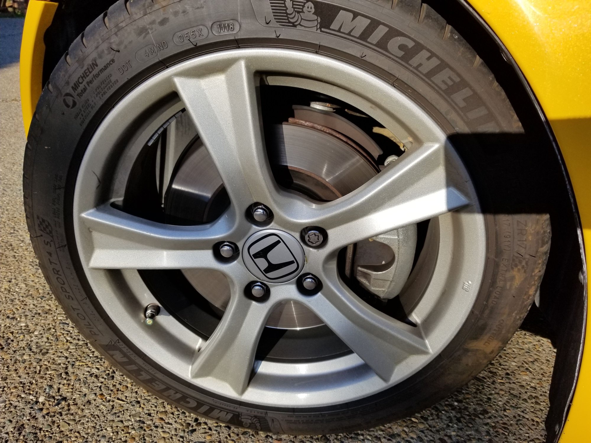

Well I am 7 years into the paint job. I just took this shot this morning as I pulled out of the garage. No wash, just unvarnished look. Dupli color has held up pretty well, IMO. Are they showroom perfect? No. I almost repainted when I got new tires. There are a few areas that are starting to chip but another paint job will do the job for the next tire change.
