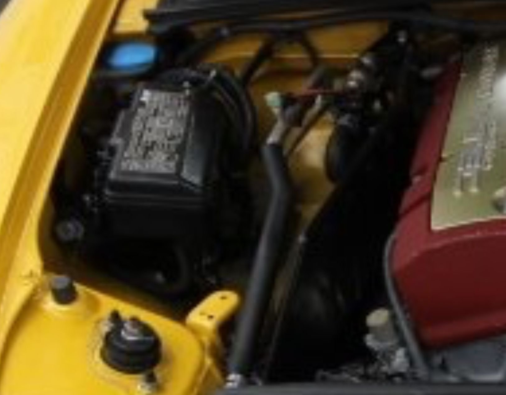

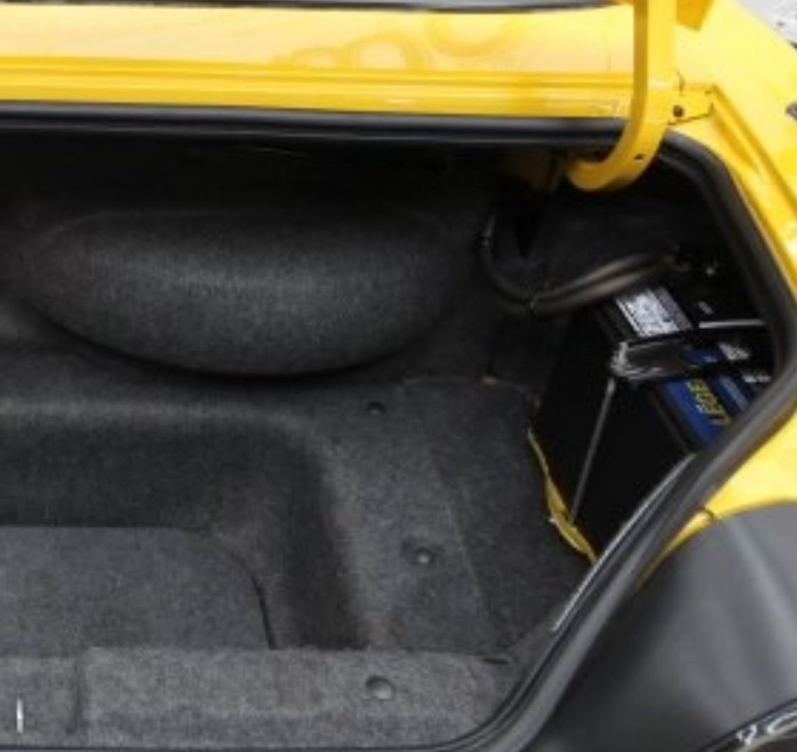

Dumb Question - I'm new to the S2000: I see in the manual for the 2006 to check the battery under the engine hood.
Yet I've seen several cars where the battery is in the trunk, right hand side. Does the car have 2 batteries?? Or is the manual I saw wrong? Did the location change over the years?

Most likely custom mounted, car only has one battery, 51R group size.

I only see one mounted, and cables running into the fusebox from the rear trunk mounting area as there should be.

So that’s not a battery in the engine bay? Pic is blurry and blown up.

Nope, that's the fuse box which was turned lengthwise and placed where the battery would be. The fusebox normally connects to that bracket attached to the strut tower. Maybe the car was boosted before?

Originally Posted by Luke-44
That clarifies but I don’t get this car. Why 2? Will this be difficult to revert to stock?
I take it this is not a photo of your car.
This person has relocated their battery to the trunk. Under the hood, they have relocated the fuse box to the battery location. Who knows why.
To see where the battery is on your car, you simply have to look.
On a stock S2000, there is one battery. It is under the hood.
If you're trying to buy the car in the photos, I would have reservations regarding why all this was done. Its usually done in order to turbo the car and move things out of the way.

photos taken with a potato are concerning.
The rear battery mounting is fine, provided the person who embarked on that voyage knew what the hell they were doing. Check to see the mount is secure and they properly reinforced the area. I'd want to see some proper corrosion protection as well in the area that they decided to drill thru the metal.

Car was 100% turbocharged at one point.
