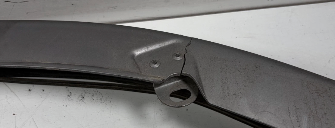

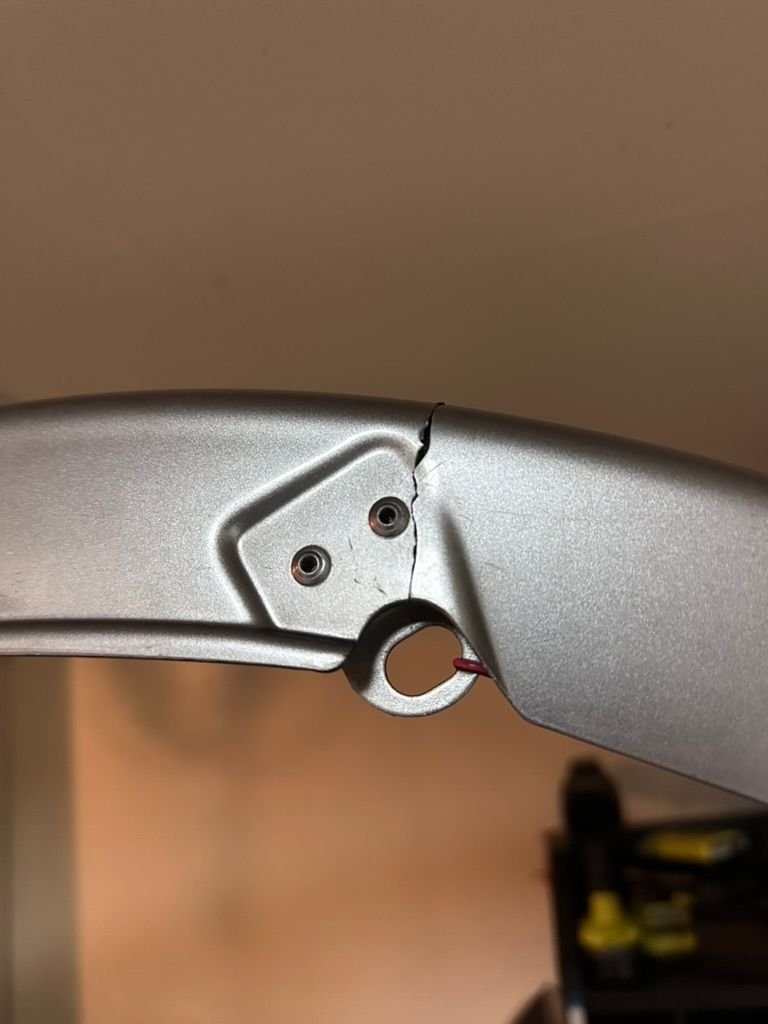

Looking to see the best way in repairing this crack on the OEM lip.
Did some research and was thinking:
1. Sand down the finish around the crack
2. Remove the rivets from the bracket
3. Reinforce with hot staples from the back
4. Apply epoxy adhesive (JB Weld plastic bonder? bumper weld? 3M bumper repair kit?), not sure what type of plastic the lip is though. It was ">PPE<" stamped.
5. Dremel a ridge on the from of the lip and apply flexible body filler. Maybe USC Flexible Glaze or 3M EZ sand?
6. Sand, paint.
Any thoughts from the experts?

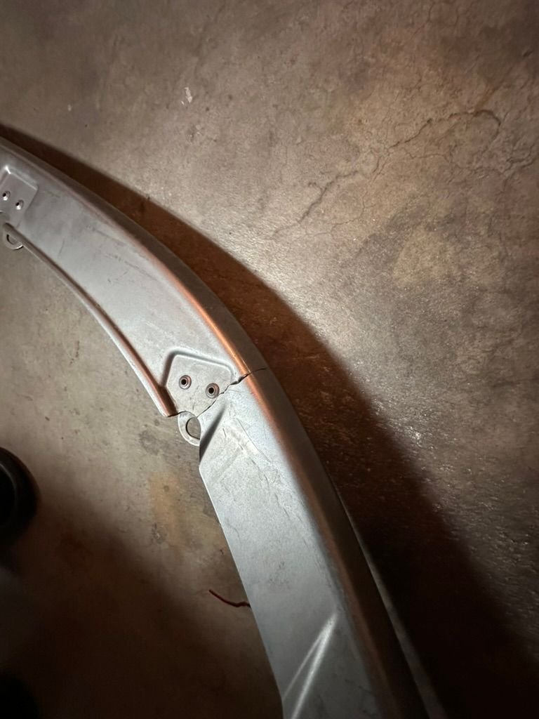

Getting started on the front lip repair and repaint. The lip came tied at the fracture point.
Structurally not too bad

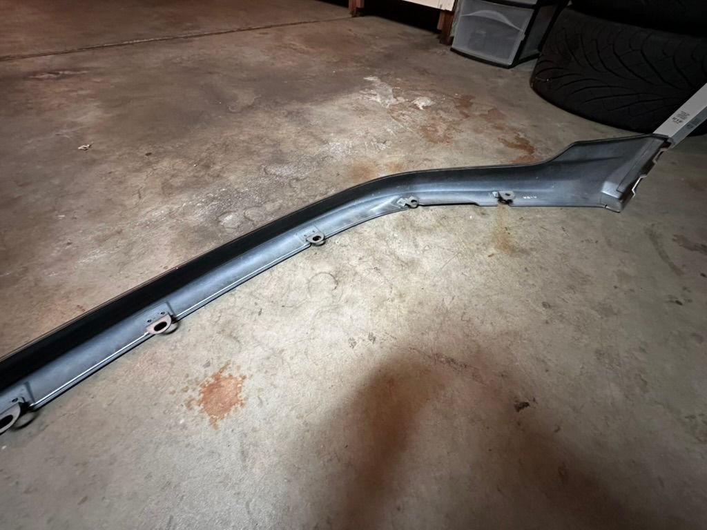

The lip is pretty light and rigid. No wonder it cracks easy.

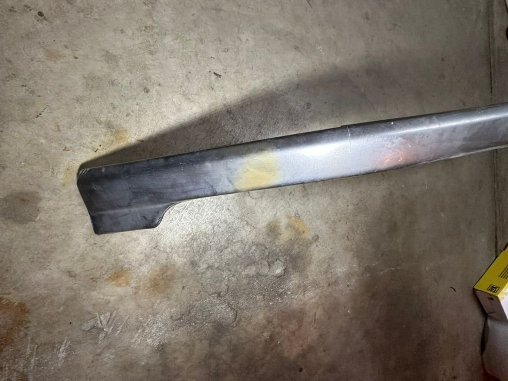

Some clear coat burn.

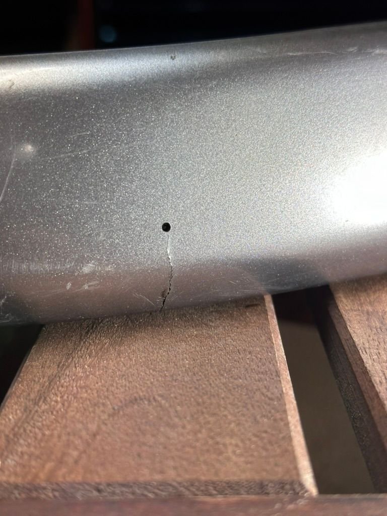

Unfortunately it's close to the mounting tabs

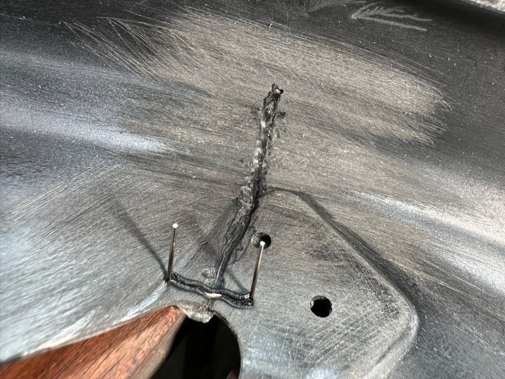

Small hole to prevent the crack from spreading

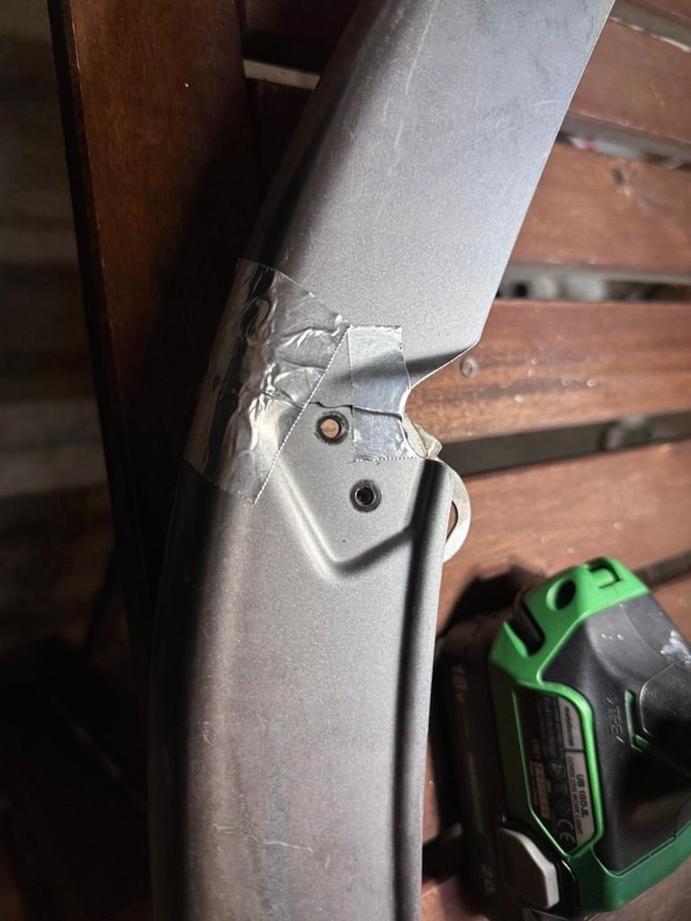

Put some foil tape to reinforce the crack. Ended up drilling out the rivets to see how close the crack was to the mounting area.

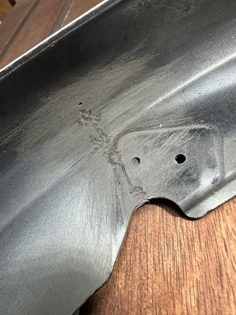

Looks like someone else tried to repair the area with a welder. Sanded with 120 grit.
Made a shallow bevel to see the crack clearer.

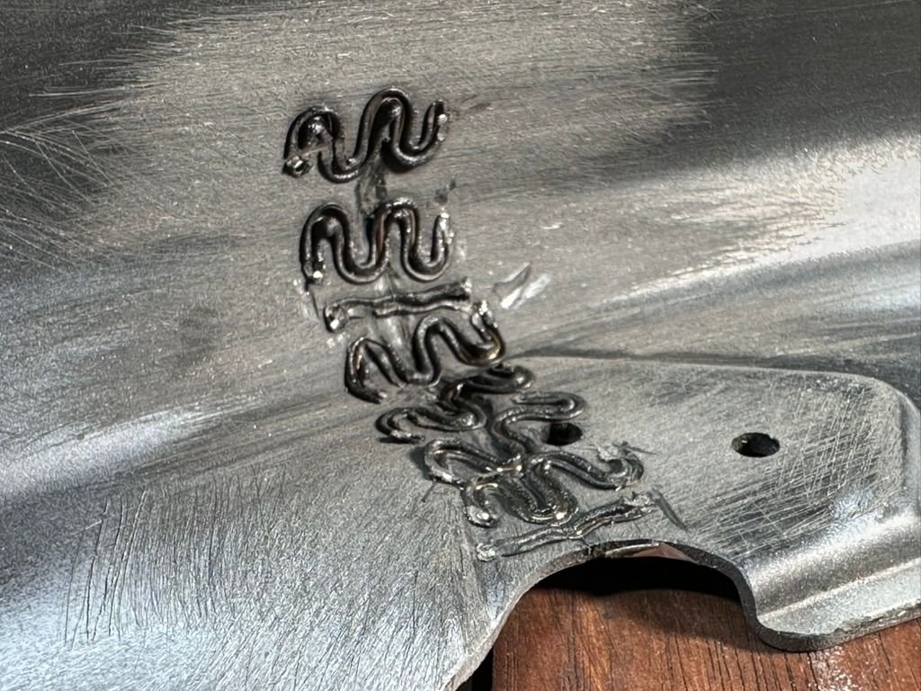

Hot staple time
Hot staple time
Impressively they provide a lot of strength. Little to not flex. I clipped off the ends and ground it down with a dremel.

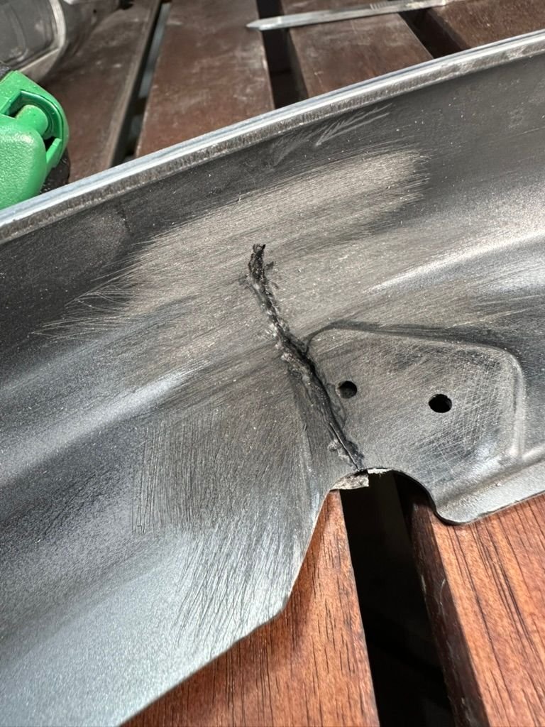

Sanded the finish off and made a
Sanded the finish off and made a "U" groove to start adding epoxy fiberglass.
