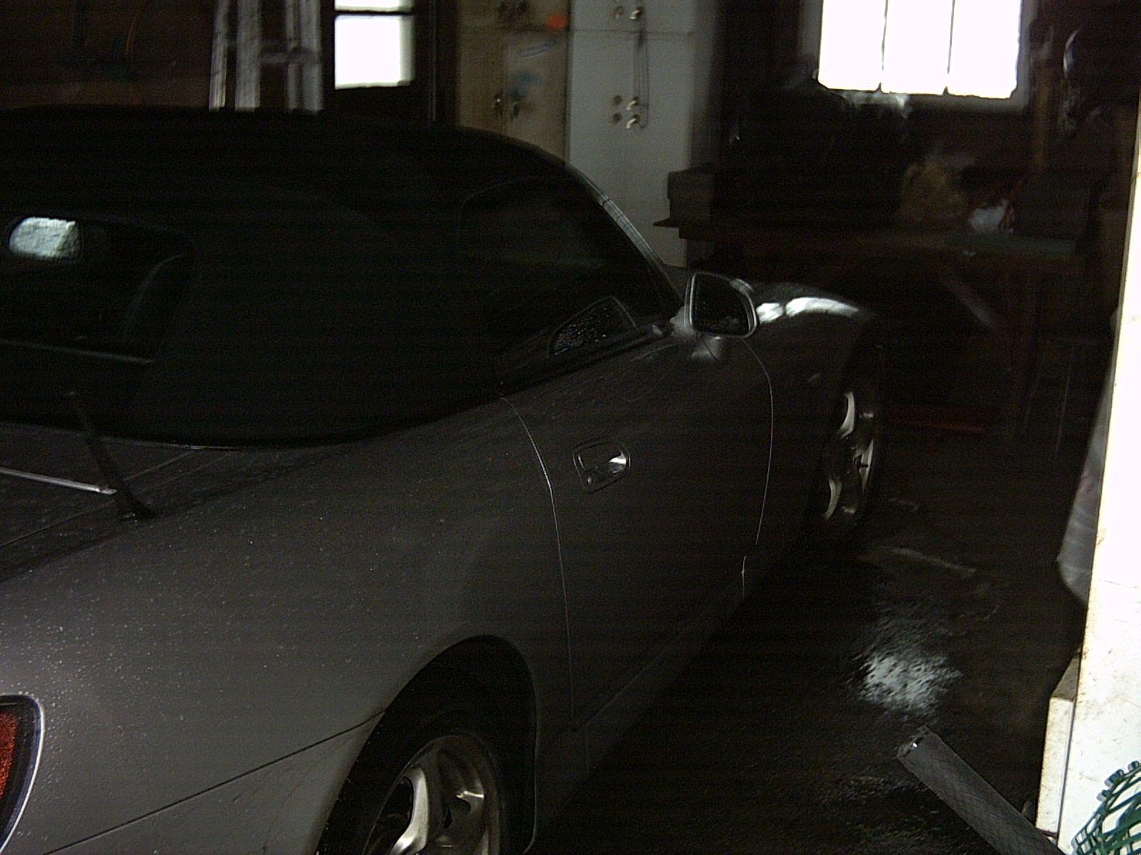

btw here is my baby, bravin the cold weather of ny in the cave
