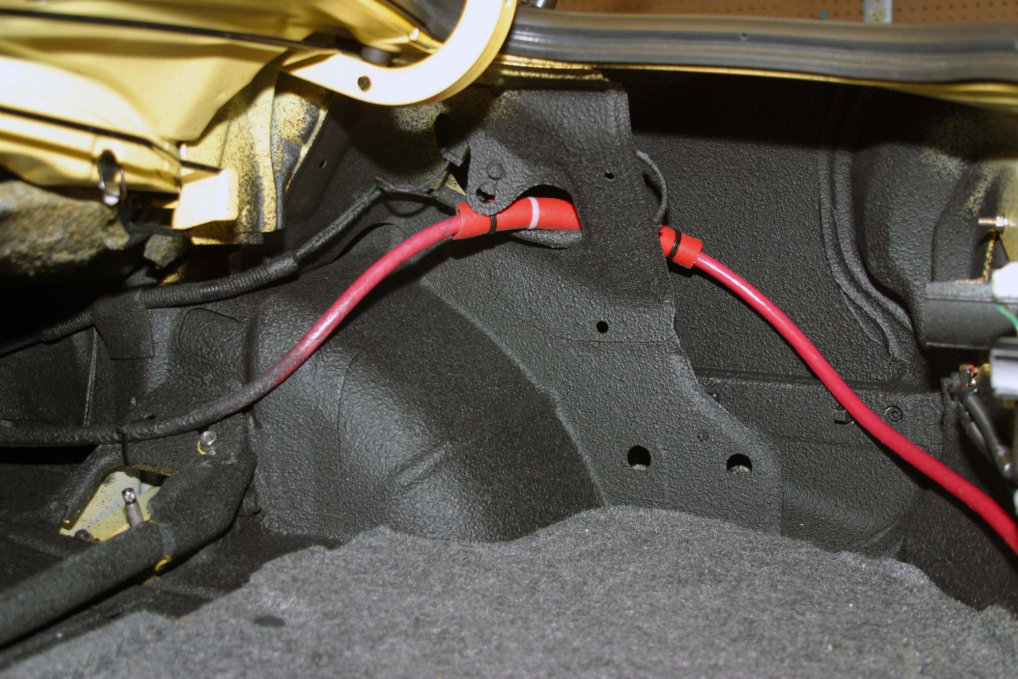

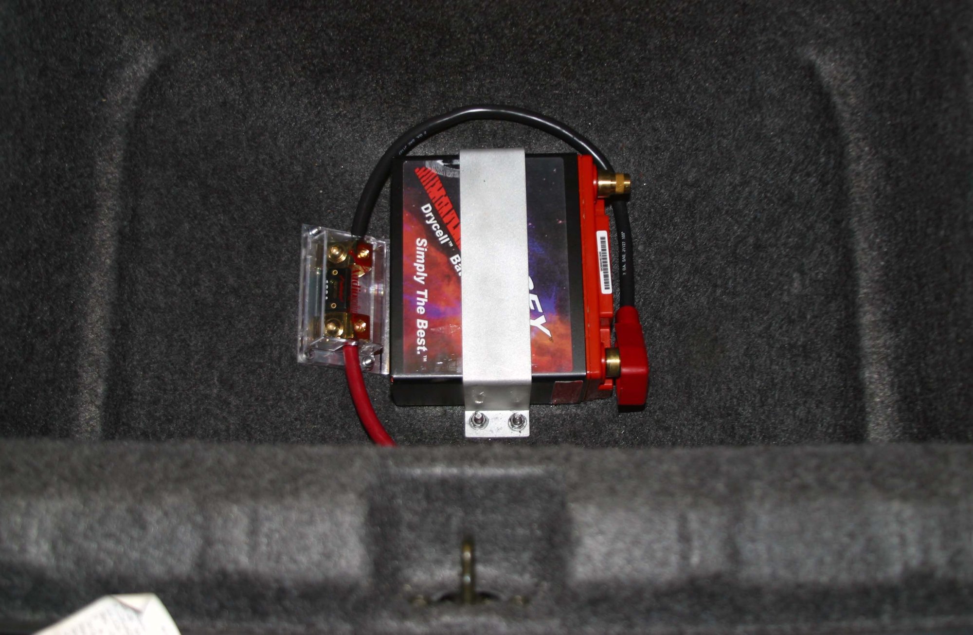

As promised, here are some pictures my battery install in the trunk:
Picture 1 shows how the positive wire (2 Gauge) is routed
