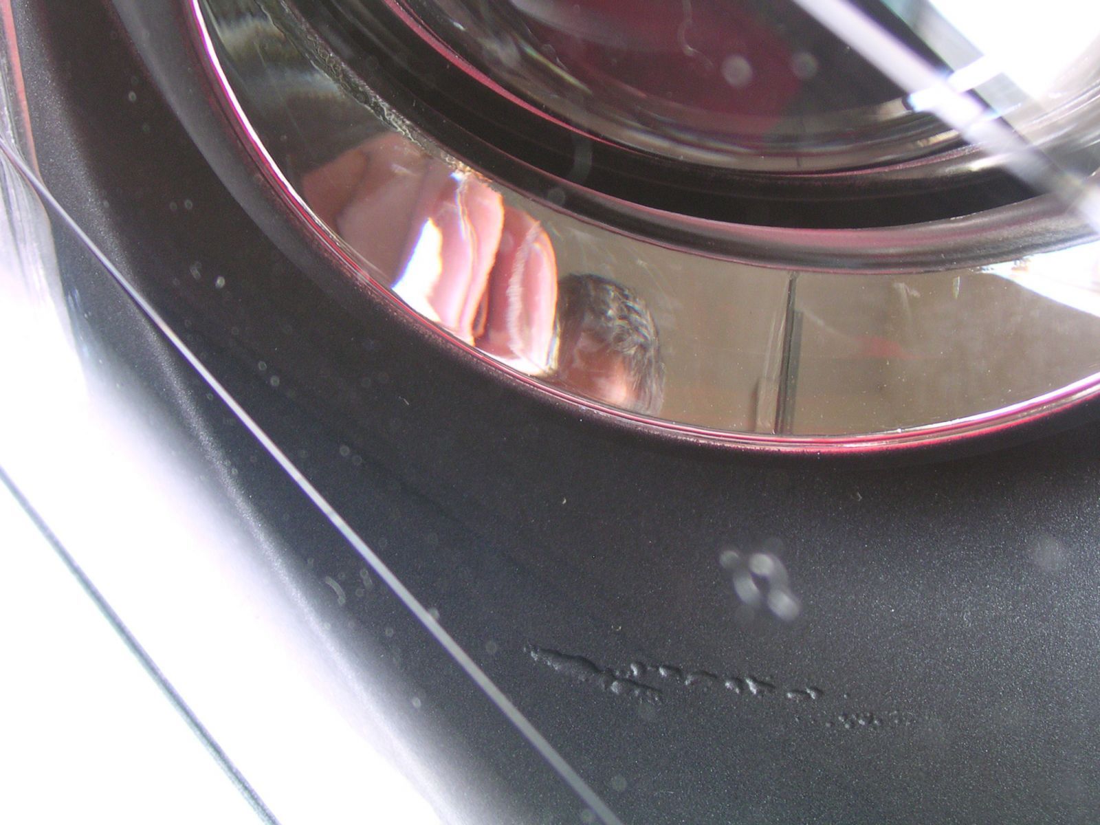

Originally Posted by rajun asian,May 5 2009, 01:22 PM
I have some too. Only on one light though.
Now, this is a perfect picture as to what I was saying. See how the lines kind of curve? Starts out small, then thickens in the middle of the line, and then tappers off again? This is due to the sun moving over your car. Starting from one side, then to the other. In the middle of the blister line was when the sun was directly over your car.
I'm not sure about your theory and I say that because my car is an '03 with 18k miles on it and has always been garaged. But who knows, it may not take that long for the blisters to start.
Really, it only takes one good hot day to do it. In the picture rajun asian supplied, you can see it had happened at least 3 times already.
Most of the time it will hit the same exact spot over and over if the car sits outside allot.
