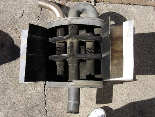

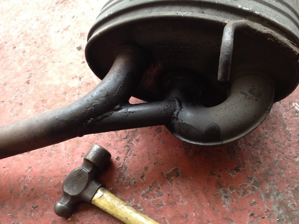

You just need to find a muffler shop who will do the mod to your stock mufflers...
Here's what the mufflers look like internally
Here is the external bypass pipe that is referred to as the 'UK Mod'
There is a Tuffy Muffler shop in South Lyon that has done custom exhaust work for me, so if that's not too far you might want to ask them about it.
