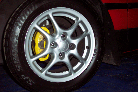

I have done lots of rims, for me I do not believe in the acid dip. In my mind the best stripping is done by bead blasting - think sand blasting but with plastic beads instead of sand, they are a bit softer and dig into the material less. In addition, I also have to point out, if the supplier is talented and has good equipment sand blasting is just fine. The person needs to have skill though because you are right, sand blasting done by some ham-fisted dolt will really tear into the surface. All of the wheels I have done have been sand blasted, but my guy is a real pro.
Original finish
Powder coated after 10-years of track use
The color is awesome, very complex
Yeah those look good, I love how much sparkle and metallic powder coat contains. Bead blasting does work good and sandblasting works fine on OEM wheels bu to me it sems like the finish on nicer wheels like Volks is a little tougher to get off then the OEM powder! And having a decent powder coater makes a HUGE difference!
