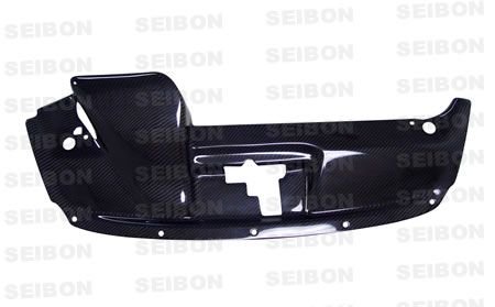

Seibon CF - Remove OEM deflector and bolt it on - too easy and a surefire way to get cool air into your factory box. Obviously won't increase intake sound, if that's what you want.

Originally Posted by nightcrawler7188,Sep 26 2007, 12:51 PM
^^removing the OEM deflector is DEFINITELY not that easy.
You're right, the front fasteners inside the bumper are hard to get to. But once you've found them they are relatively easy to remove.
I've seen some just cut out the deflector on the passenger side to allow more air flow up into the intake, but the cooling plate is designed to seal the area above the radiator so it makes the deflector more or less worthless.

Don't remove the OEM deflector, just cut out a panel on the passenger side. The stock plate keeps air pressure high in front of the radiator and is part of the fluid dynamics of the engine bay.
