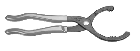

I had the same problem this weekend. I have the socket type wrench and it rounded off the corners on the damn filter. So I put new oil in it and went to autozone the next day and picked up this.
It just bites the thing and you can just rip it right out.
It also helped to take the air filter box loose and move it aside a little so I could get more movement with my hand.
FYI, its not a big deal to change the oil then the filter later, the filter is above the oil line so you just lose a little oil from the filter area.
