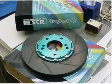

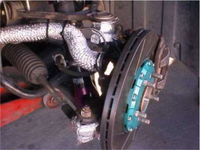

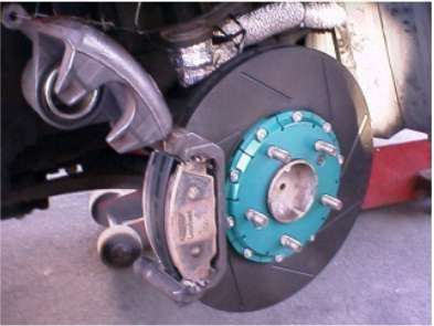

I found these pics while JDM shopping.
I don't know if there is such a thing, but this rotor looks suspiciously like carbon.
Notice how thick the material is, and how much smaller the vanes are?
What do you all think?
-Pete

There is a such thing as carbon rotors, but those don't look like em. I don't think carbon rotors have cooling vanes, and they are not slotted.
I don't think it would be possible to use carbon rotors for the street because of the required operating temperature that must be achieved before braking becomes effective.

This car is probably a track car. I'm noticing the cooling duct work, and the rubber suspension components near the brakes are foiled-over.
The coloring of the rotors is also interesting. I doubt there could be any kind of coating on the surface that contacts the pads, so that must be the inherent color of the material. Maybe it's from some kind of treatment, but I'm thinking it could be carbon.

Anything is possible but the rotor you found is from Project Mu
A little search and I found this...
http://www.project-mu.co.jp/e/product/scr-pro.html
The rotor you mention is the SCR-PRO
Material: CV cast iron and aluminum alloy

They're heat treated cast iron. The oxide surface hasn't been removed, thus the color. The box was a giveaway. Check out this site:
http://web.ask.com/redir?bpg=http%3a%2f%2f...default.asp&s=a
They do look nice!!
Thanks!
