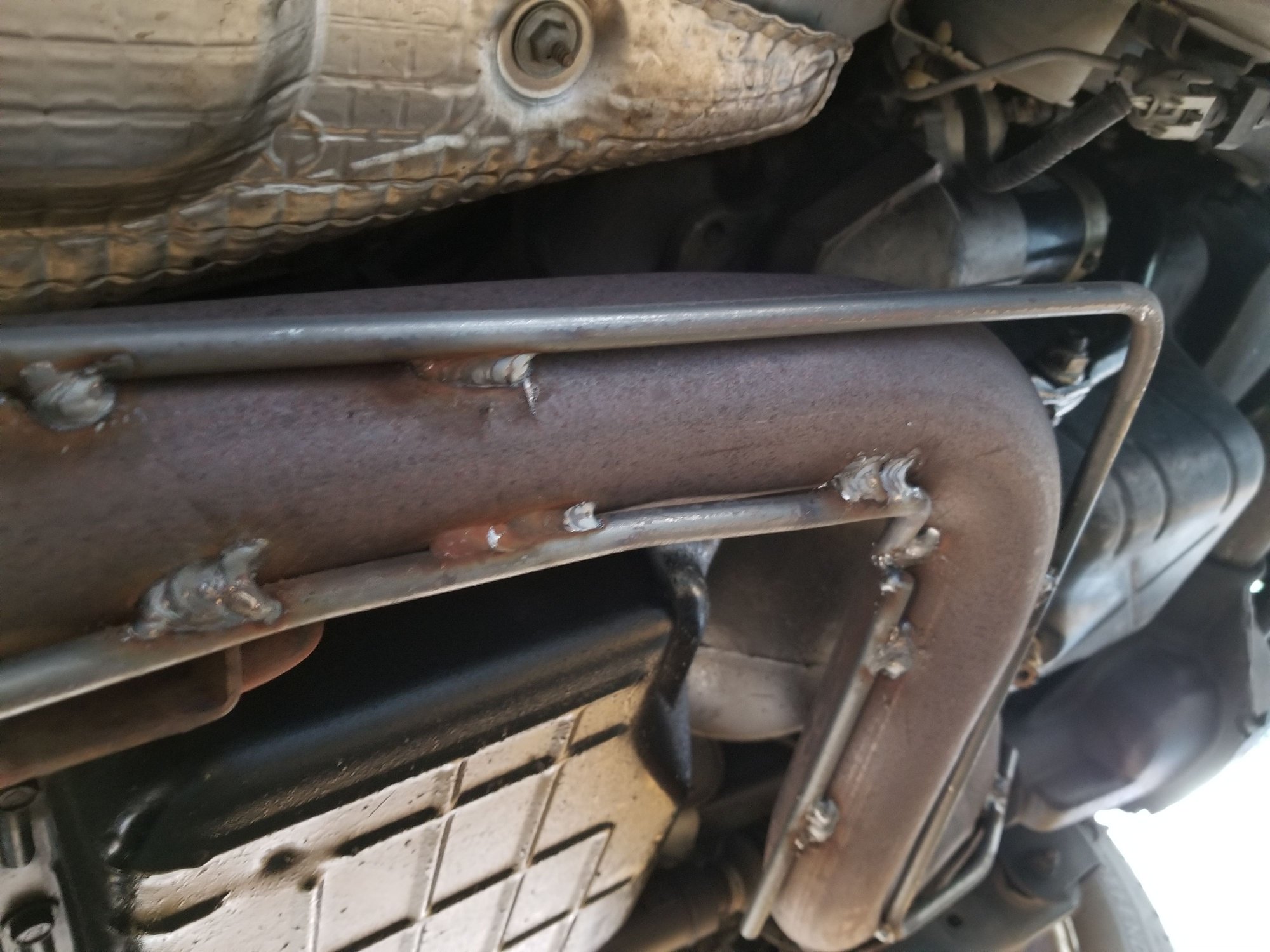

The tray idea has been used but it depends on the vehicle. My Jeep, for example (look at the above pics) has the CAT extending down below the frame rails (yes, body on frame - no unibody) so you would have to make some kind of a box to house it at the same time thinking about the hight temps the CAT generates.

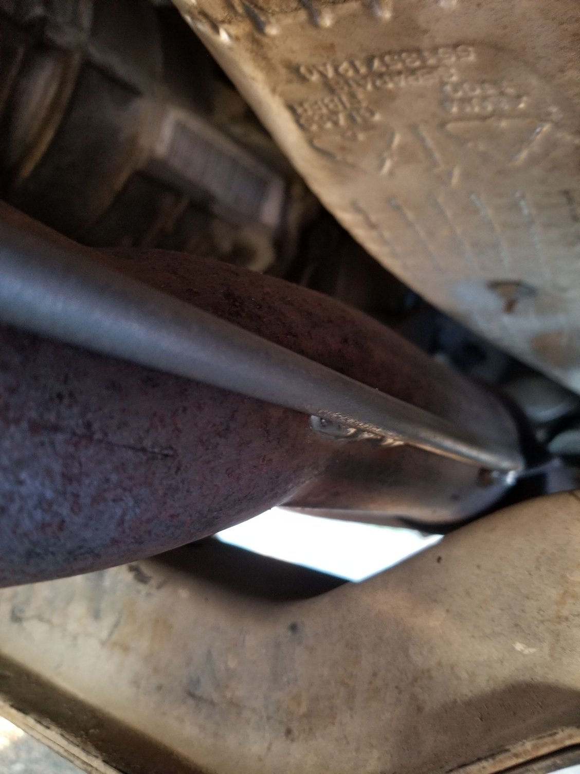

I took a few better pictures than the ones I had earlier. Stainless steel, hardened rods on both sides. Enough to deter the basic clown.
