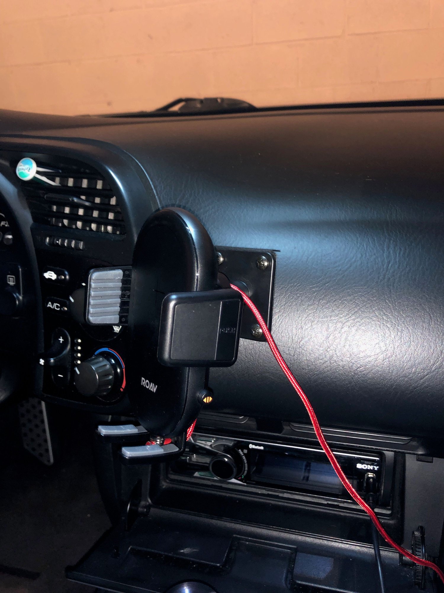

Are you me? I had just done this same setup.
Tried looking for someone that had did this prior to doing it too so I could see what would mount up to the modifry.
I used this aluminum adapter plate because I was iffy on the plastic ones
iBOLT Aluminum 17mm AMPs Adapter Plate
I also used a quick disconnect magnetic usb to plug into the Qi incase the wire gets in my way I can pull it off quickly. For now I have it run over the mount then tucked under along the console, not the cleanest wire to look at but so far it has done the job and is out of my way shifting
