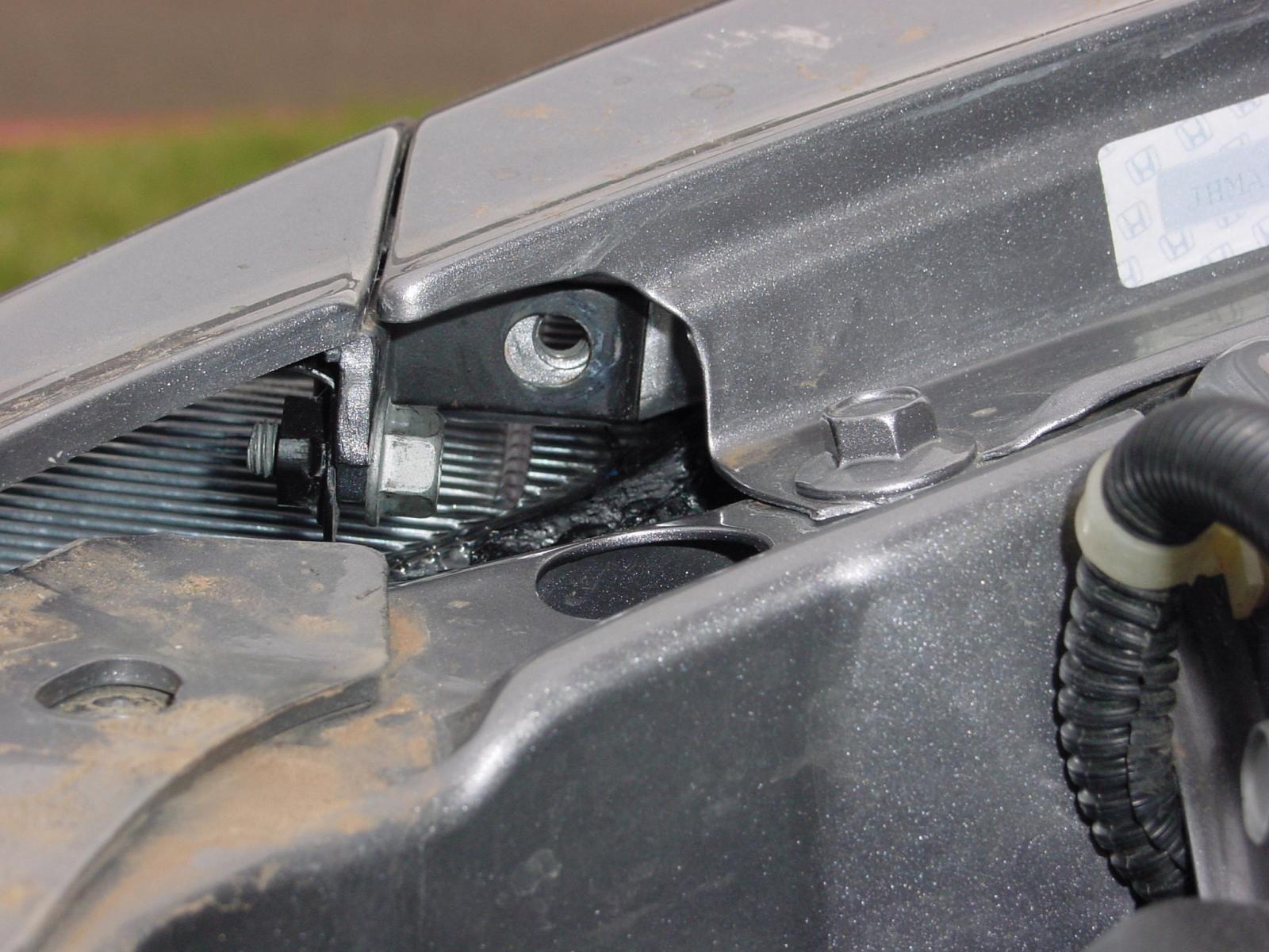

1. I don't have a helms manual so I was initially worried about getting my front bumper off. I was unsure of all the various bolts and their locations. So here is a quick breakdown of what to expect. Start with the black strip with the weatherstripping on it in the engine bay. Undue the phillips screws and take the black strip off. Now look to the left and right where the weatherstripping tucked under the fender. You will see a bolt facing out at you. Remove that one. (see picture)

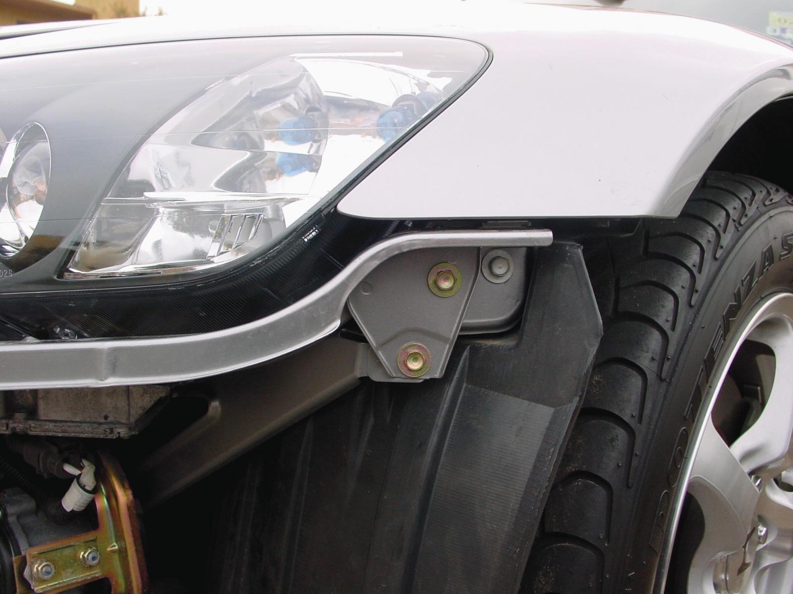

2. Next comes the headlight. First remove the metal brace under the headlight. There are four 10 mm bolts that are gold in color that hold that in place
