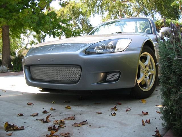

edasaurus's Avatar
Posts: 293
From: Culver City
I posted this pic on the Silverstone thread in the Photo Gallery, but for those who didn't see it...
