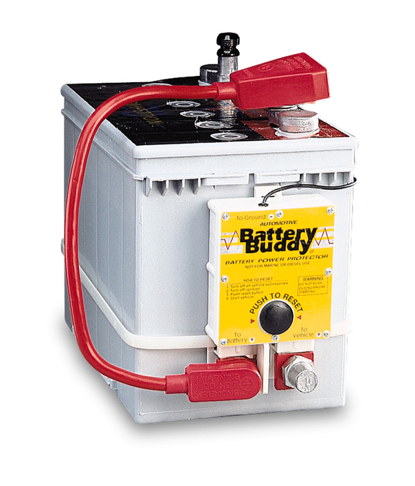

Might also want to consider an "Battery Buddy", there are a couple people who make these items. This one is from Crutchfield.
