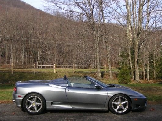

No, no, I just have one Ferrari at a time, and that is stictly a private, truly enthusiast affair. Far away from scrutiny. I only use it on mountain roads upstate NY. Not colored red, no parading.
I use the S2000 (as I did with the Elise) to visit my clients. They have no clue I have a Ferrari, but they all know I'm a car nut.
If they would find out I have a Ferrari they would think they are paying us too much (which would be close to the truth, but not quite).

^ That is such a beautiful car.
