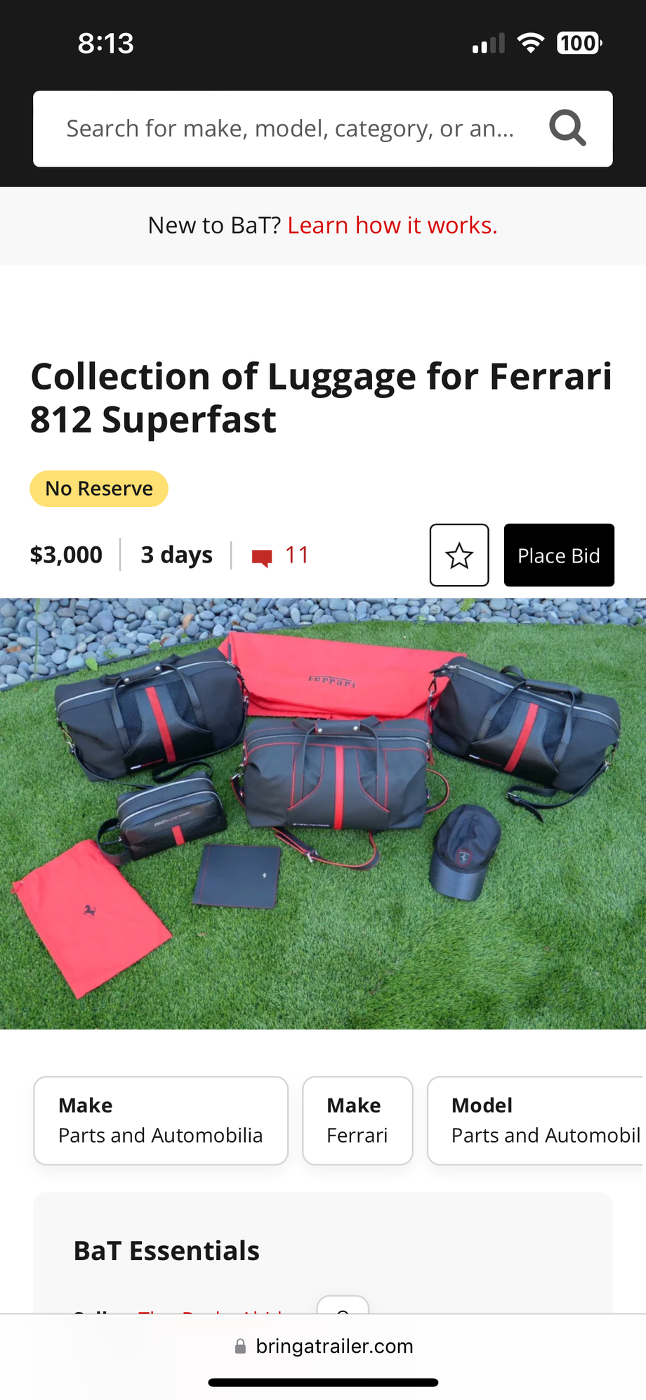

Happy New Year everyone!
I was scrolling BaT yesterday and came across this
I have always wanted a custom luggage set. It’s a little more necessary when you have limited cargo space, but I happen to think the S has a pretty generous trunk. One of the reasons I bought the S was for touring the country with my wife. The idea of packing up a couple duffle bags and hitting the road always puts a smile on my face. While my yellow North Face duffle sort of matches, that bag has seen the world over and is ready to be retired. I think a leather set would be nice but I don’t want to put Honda logos on it.
Has anyone seen/made a set?

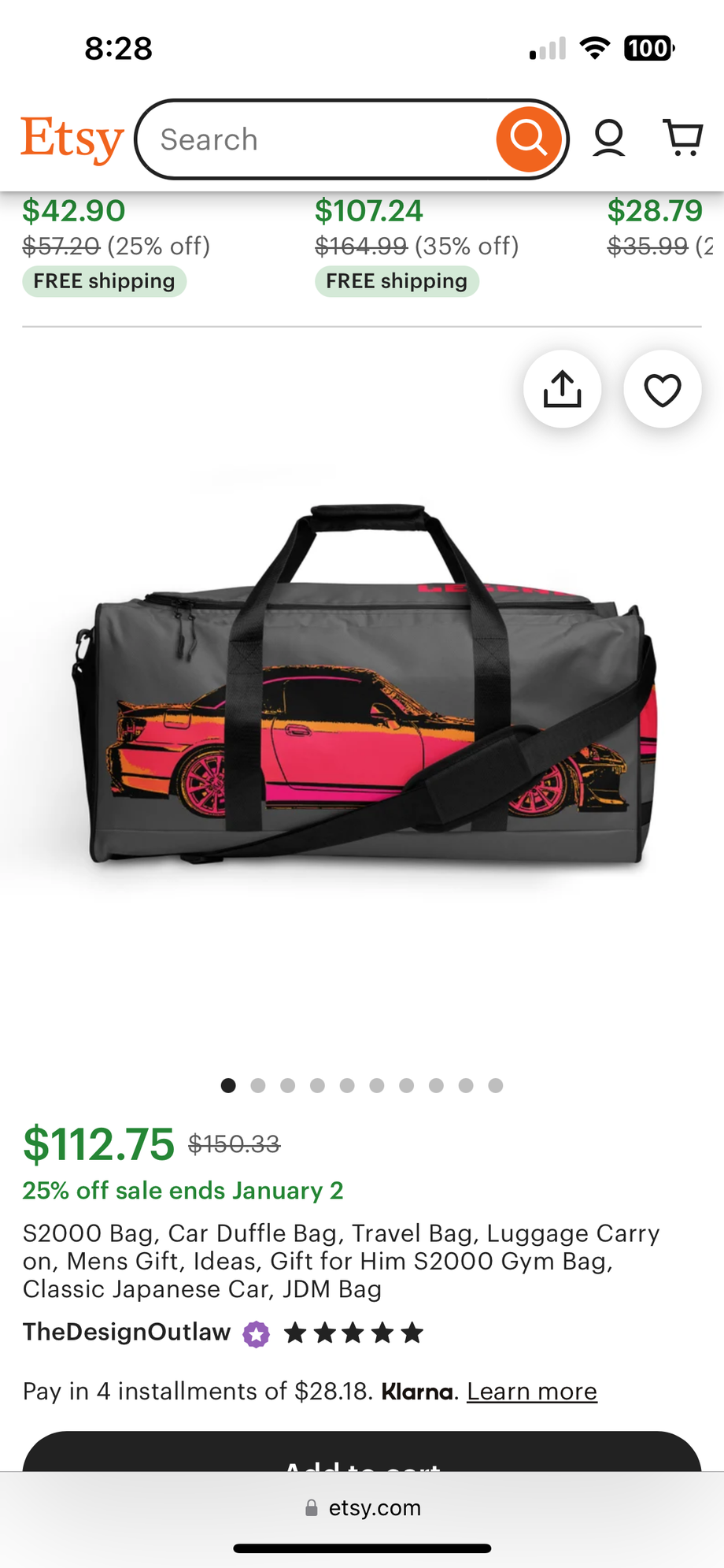

This isn’t what I had in mind but it’s kind of cool.

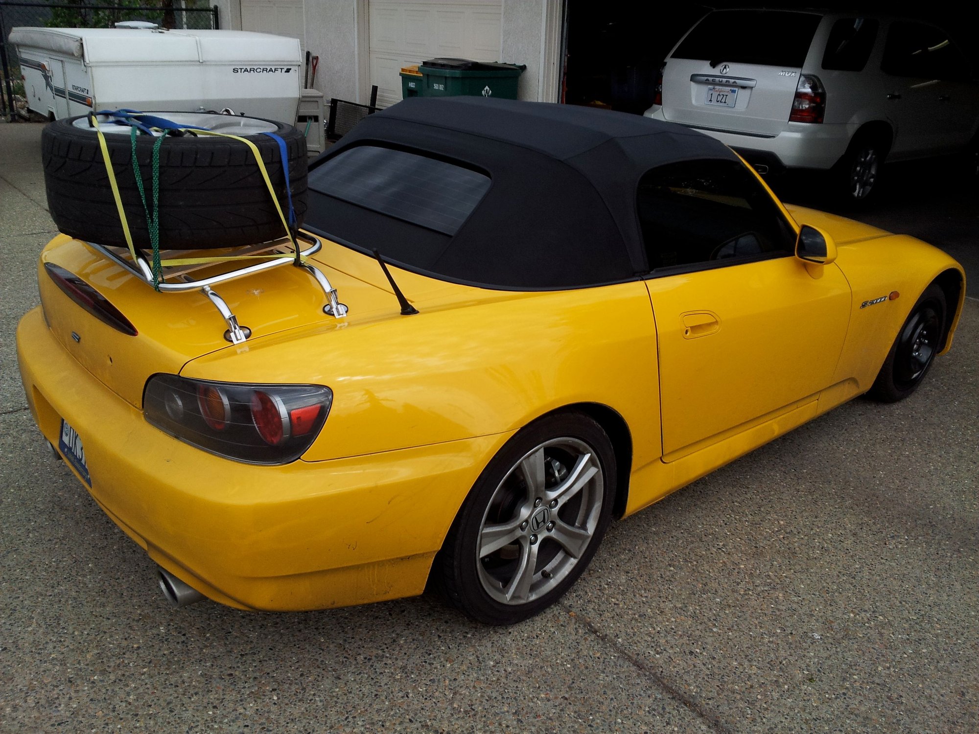

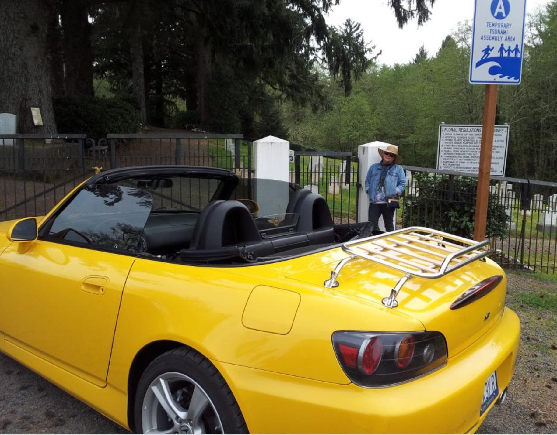

Been there, done that, respectfully disagree. Wind resistance is high, gas milage will suffer big time, and the big deal is: you can't put the top down and see some of the best driving scenery this country has to offer in California. That is the joy of the S2000. Wife and I have taken many longer trips-up to 2 1/2 weeks, and found a Surco trunk rack the way to go. (As well as careful planning for the trunk) Up and down Hwy 1 so many times, up to Canada and back down to Death Valley. Yosemite, Big Trees, Gold Country, Bristlecone Pine, Sequoia, Redwoods, Lost Coast, Pt Reyes, Carmel, the Central Valley, Coronado (home town) Northern Coast, Lassen, Hat Creek area, Lava Beds and the list goes on and on. All top down. PM me if you want some travel ideas. We got pretty good at packing the trunk, even getting room for tulips from Amsterdam and appropriate beverages. I also have a Tire Plugger and inflator to repair flats as well.

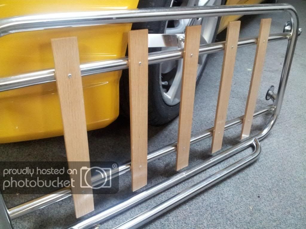

I added some oak slats to the rack keep anything from slipping through and hitting the paint. It takes a minute to put on or remove. I use some packing tap to make sure the rubber discs on the rack feet does not mar and keep the metal J hook from doing anything as well. I glued some thin rubber/plastic inside the J hooks for added insurance. Have not had any problems there. I found you do not need a tool to crank it down. Just barely snug is all you need. Great rack design and well made. It is great for bulky stuff like chairs or tents. It can hold a flat tire and in that regard, it saved the day. It was the rear tire that failed so you have to put the front tire on the rear and the spare on the front.
You do need to be aware of what is on the rack as it will really slam close if you forget or let go of it.
No worries putting the top down quickly as that is the real fun of a drop top car.
