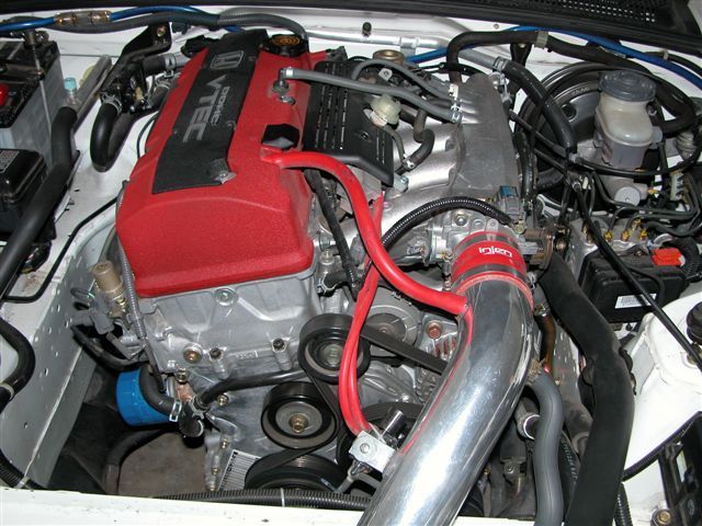

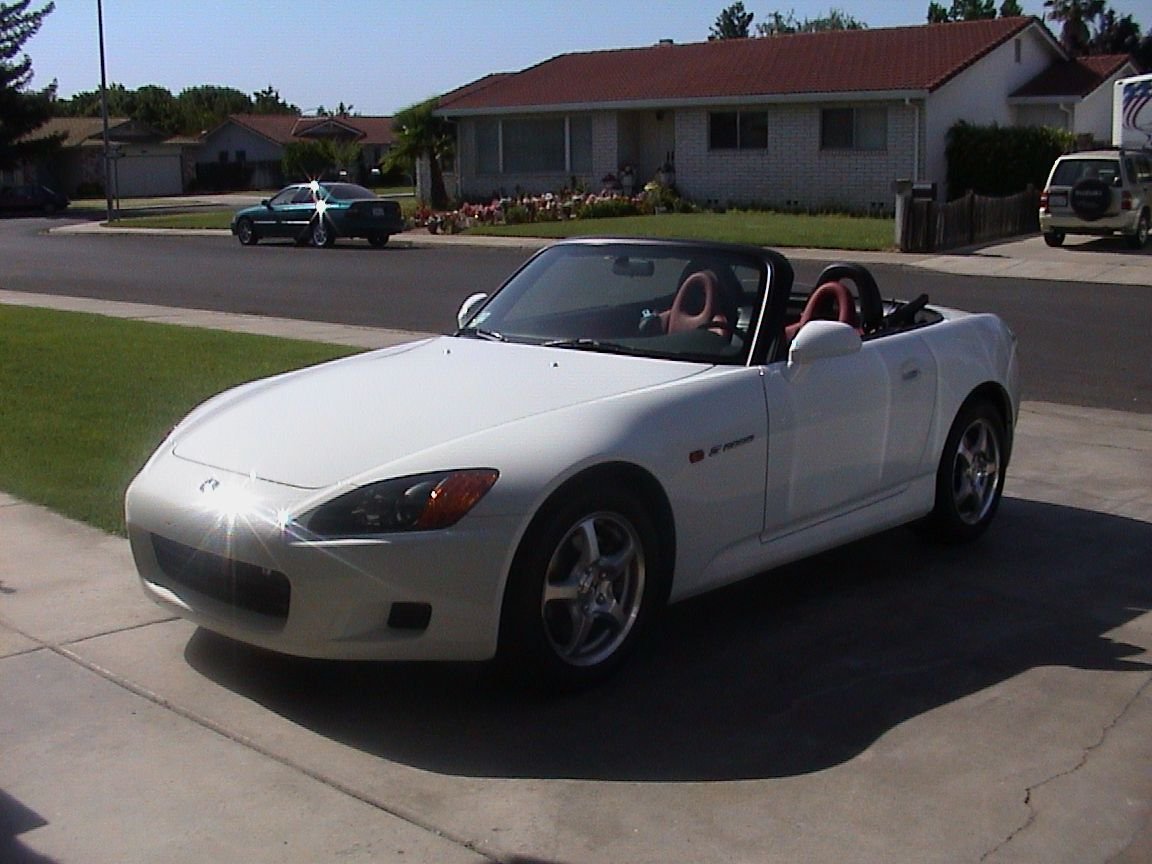

Ok, I've located the car that I want. I've spoken with the owner and I'm confident that he has taken "good" care of the car. Downside: car already has 36K miles on it Upside: I'm getting the car for $21,500. Below are a few pics of the car.
I'm wondering if there is anything specific to the S2K I should be looking out for when I see it on Saturday. The carfax came back clean, but should I look for anything in particular? What I'm really looking for is tips on determining if mods have been done. I'll be looking over the car very closely. I've been doing my share of reading and searching...but any help would be appreaciated.
Specs:
2001
All stock except for Injen CAI

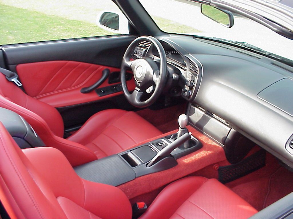

Compression check for sure. Also, check to see which TSB's have been performed. From the pics that looks like a damn nice used S2K. Especially the interior shot. Nice color selection.

The cars look to be in good condition. Congrats! Nice color choice, too.
