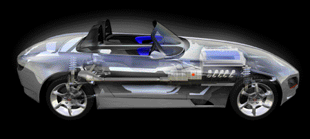

Default Did honda intend to put in a I5 for the s2000?
i know this is the prototype, maybe honda found engine bay clearance issues.

Hey - an 8K redline and an automatic?????
Hey Raz, I assume Honda could produce an I5 with the same RPM capability as the 4 - but isn't the firing order an obstacle? Honda has made V10 engoines, right, but there the offsetting balance is different.
Whadaya think - an I5 was an Acura engine at some point, right?:

Acura used an I5 in the Vigor and the 2.5 TL. In this configuration it was a 2.5 liter engine with 176 hp. It had a nice torque curve (long crankshaft I guess), and was only a SOHC engine. The prototype SSM was a 2.0 I5 with DOHC VTEC. I don't remember if this engine ever had an official power rating, but I seem to remember around 250 hp. Honda decided to go with the F20C because they were able to offer the same performance with better packaging.

maybe they used the 4 cylinder so they can cram the whole engine behind the front axle(in order to acheive 50/50 weight distribution). i love this forum, you learn something new everyday.
