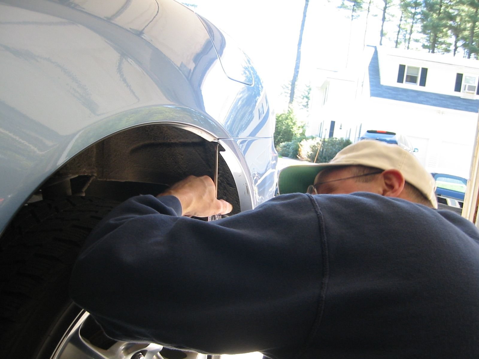

Step 2 - Removing the wheel-well screws: You must unscrew all the phillips-head screws that secure the bumper cover to the wheel well. There are three on each side of the car.

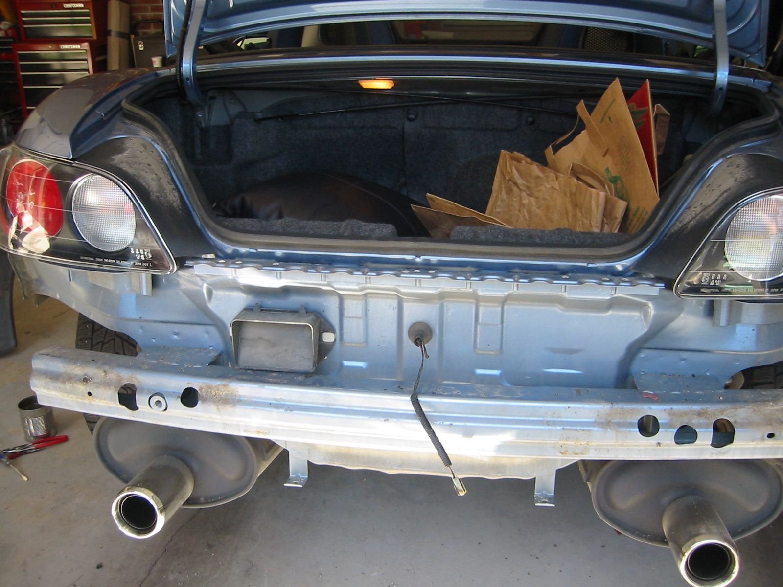

Here's a shot of the bumper cover off. I strongly recommend placing the bumper on the ground (or carpet) with it's bottom edge on the ground. Don't ever rest it on the top edge, as there are a few pointy edges on top that can get blunted if you scrape it on the ground. You will, however, definitely want to wipe the inside of the cover off as it has collected lots of dirt.
Step 7 - Remove the styrofoam bumper pads. These pull straight out. They collect dirt, so be prepared to dirty your floor!
Here's a shot of the styrofoam removed from the bumper, and a clear shot of the harness. Note also the trunk pressure flap which, FYI, lets some air puff out when you close the trunk.

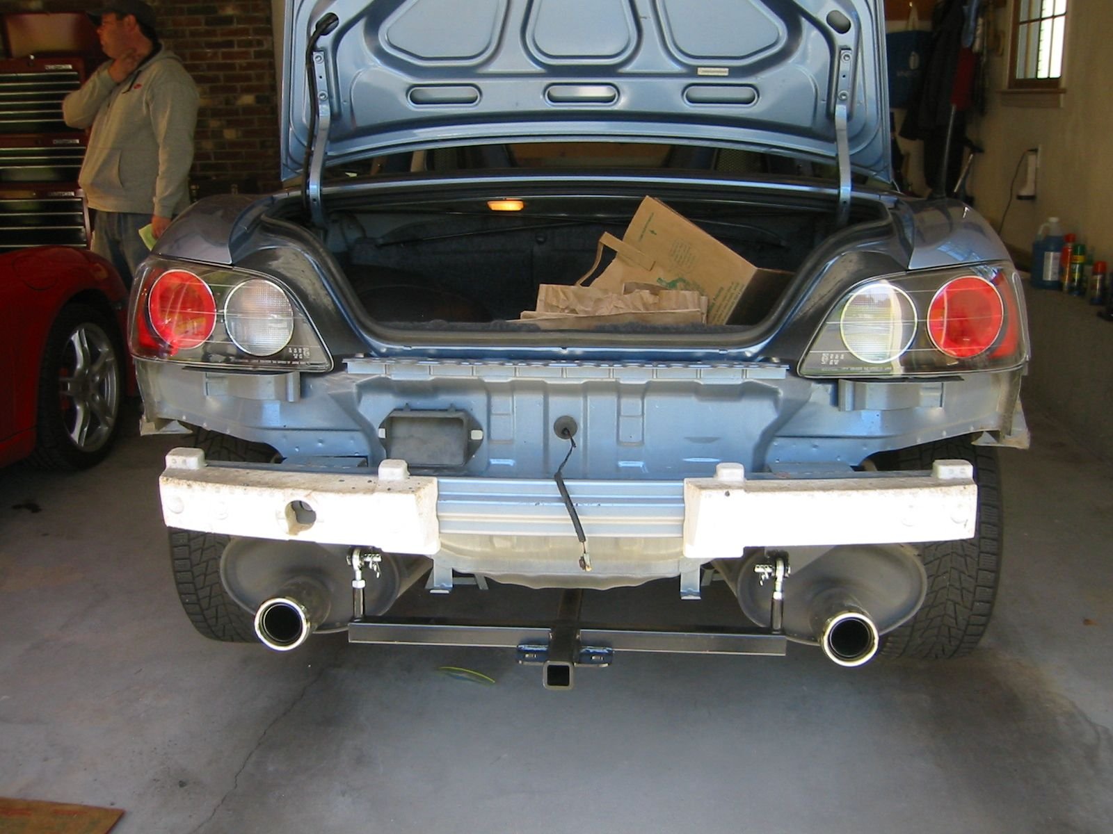

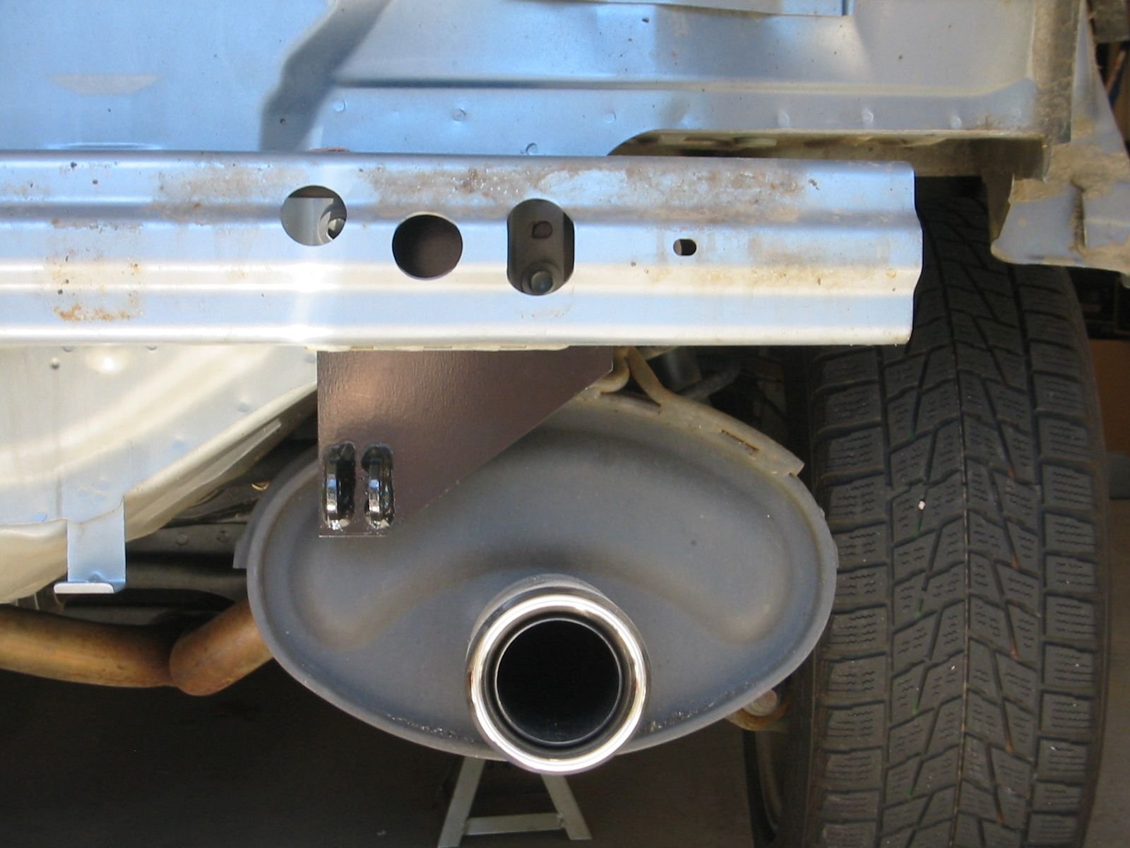

Step 8 - Installing the hitch's bumper plates: Doug's site says you should remove all the bumper bolts and the bumper itself, but that's not necessary. Instead, do one side at a time. Take three bolts out of the left side, and install the left plate (put the bolts back in, but leave them loose so you can move the plate around!), then do the same with the two bolts on the right side.
Here are three pictures showing the installation of the plates. At no time did I have the metal bumper off the car.
Step 9 - Installing the hitch's cross-member plate. Doug provides two longer bolts to replace the originals. Just remove the originals, and bolt the plate onto that cross-member behind the differential. Note, this is why you need jack stands on the frame -- a floor jack on the diff will get in your way here. Again, bolt this in, but not tightly yet.

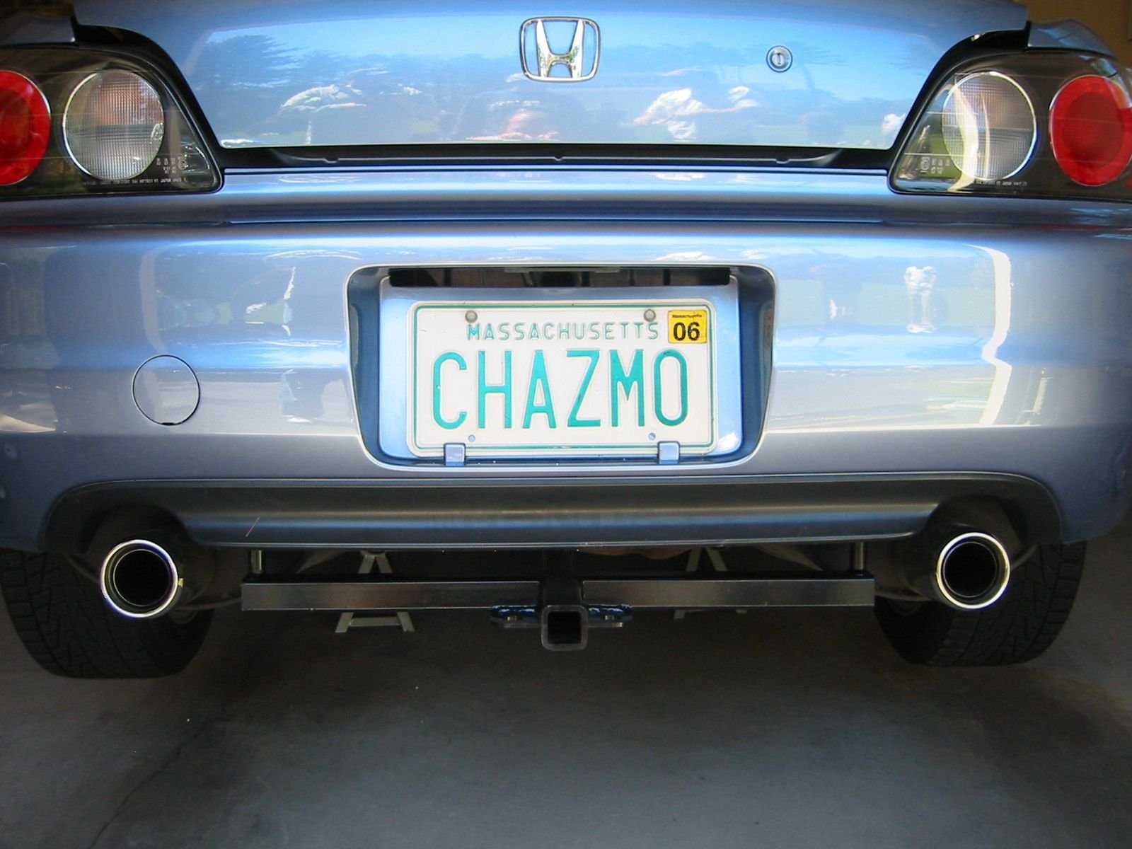

Step 12 - Lower the car. Place the floor jack back under the diff. Also, you might want to put a couple of 2x4s under the tires when you lower because the T-bar hangs down now. Remove the jack stands and lower SLOWLY, moving the floor jack to the side so the T-bar doesn't come down on it.

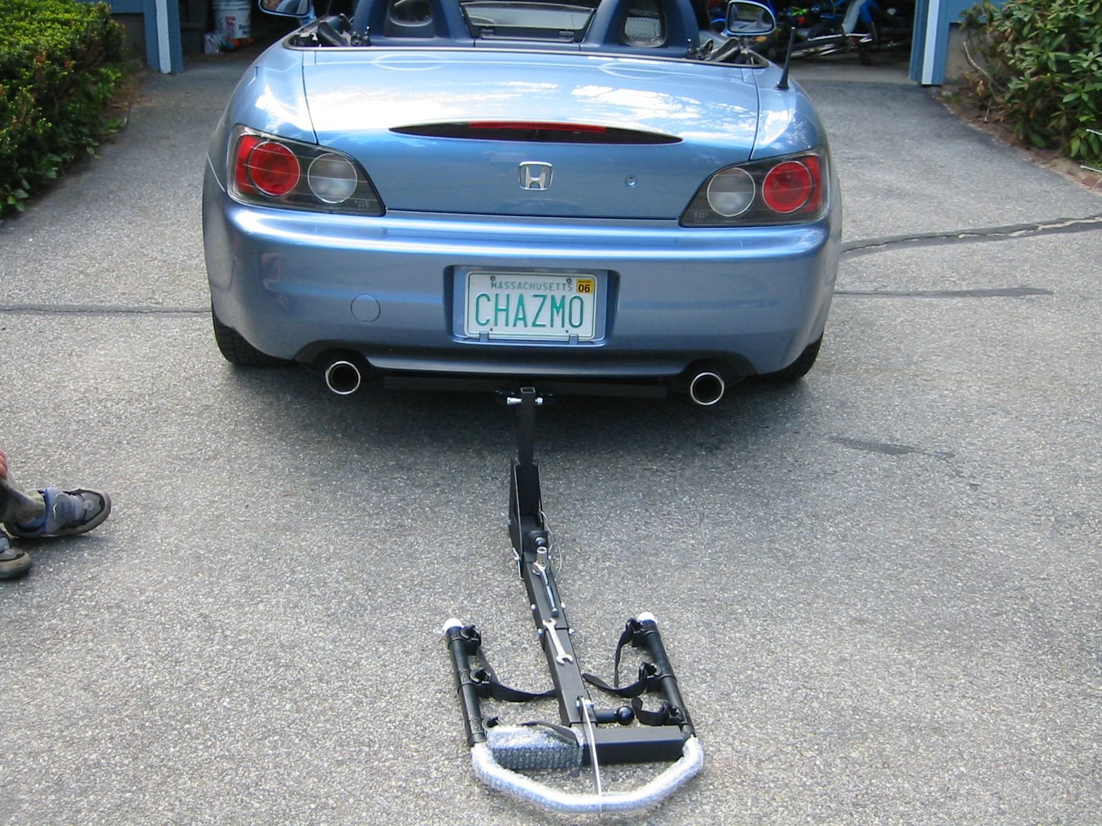

If you're like me, and you want a bike rack, Allen makes a relatively inexpensive 3-bike attachment that requires about 10 minutes to assemble.
Go lay this out behind your car.
Lift it up and slide it in!
Seriously happy Chazmo!!! Once again THANKS, Legal Bill and Bass!!!!!
