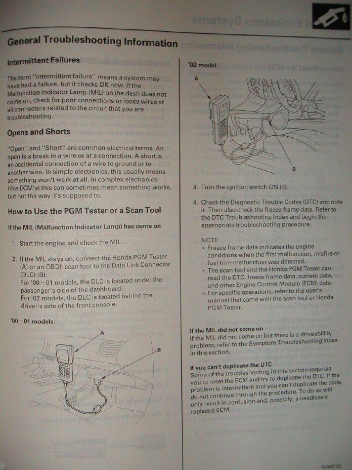

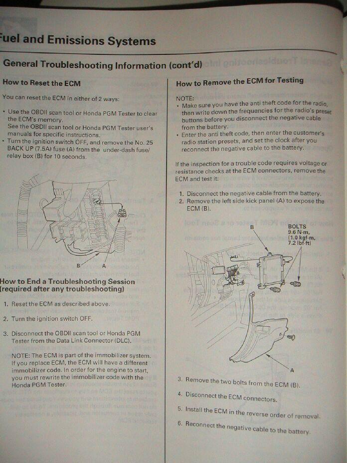

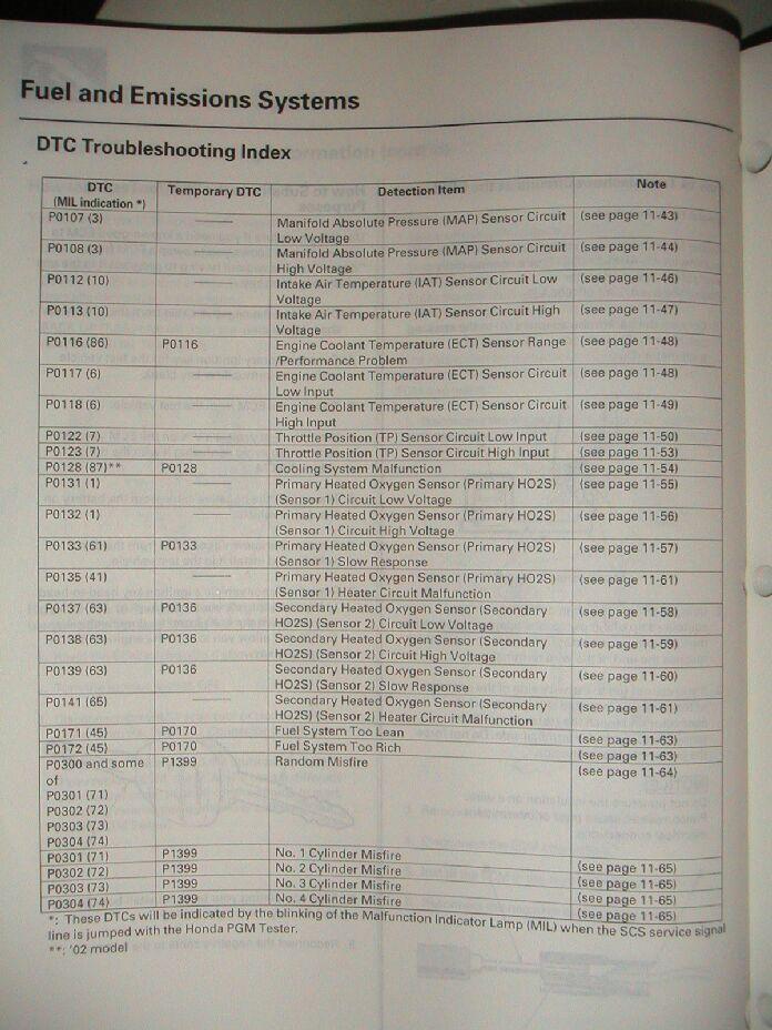

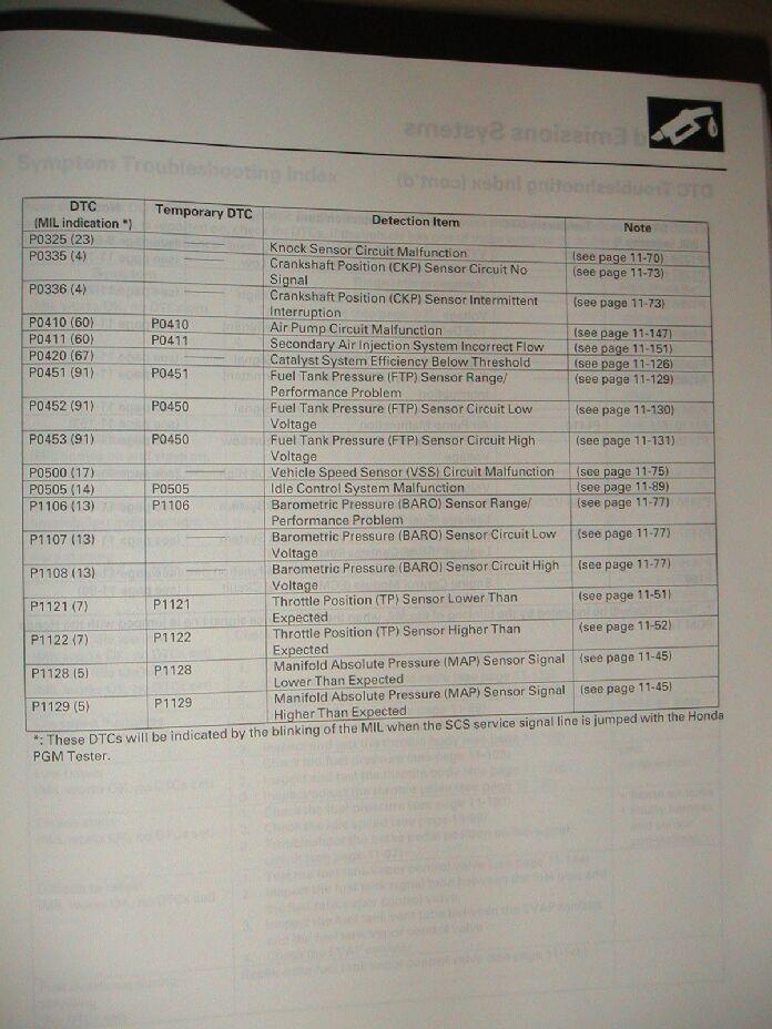

Here is the list of codes. But notice on the right hand column, you still need the manual to see each page for each problem. (I just can't take pics for over 30 pages and paste on here)

Holy sh!t man! You didn't have to go thru all that trouble for me.
It's people like you that make this site wonderful. Thank you very much.
