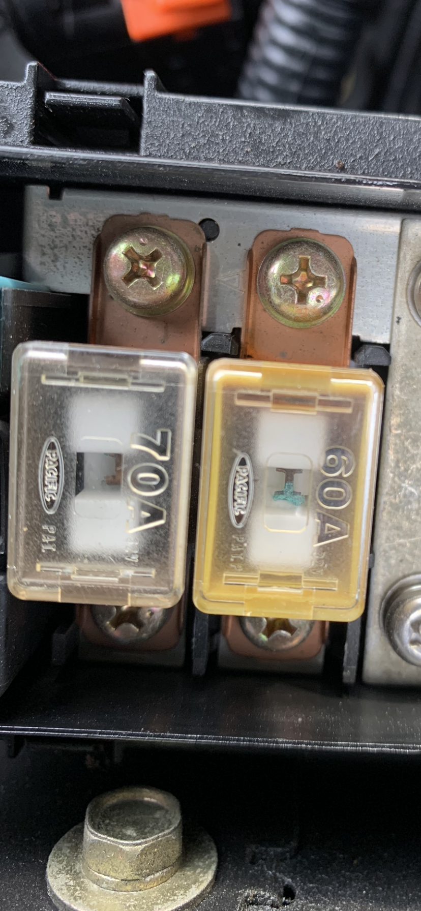

thank you for your reply, I thought of my low battery as well and I replaced it, but that didn’t fix the issue. I’ll be getting it reset tomorrow most likely! I was thinking of my fuse but doesn’t look bad. My air pump fuse is corroded and it’s beside that fuse so maybe it’s corroded as well. But that’s too easy lol

That Dont look good at all. That’s a lot of corrosion. Corrosion and rust is a highly resistant to current flow. I’d take a closer look under those fuses and make sure you’re wiring harness is t like that

I replaced both fuses this morning but I didn’t look hard enough under the fuses. I’ll take them out again and look and check for corrosion. Thanks for the tip. When I replaced the fuses nothing changed unfortunately, but maybe because I need to reset the light. I don’t know, time will tell!
