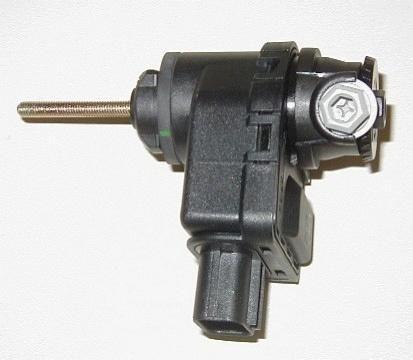

I had a friend in Switzerland purchase a leveling-motor for me to use with a set of European headlight housings:
The motor is part of a system with a rear-mounted level that adjusts the aim of the headlights during rear weight changes... like when you carry heavy packages in the trunk. This is not a dynamic leveling system for bumps in the road but a "trip-long" leveling system that moves the aim down quickly but not that quickly... and then returns the aim to their "normal" position when the suspension is returned to normal (that heavy package is removed"
While you might say "how could I fit that much stuff in the trunk to weigh the car down enough to change the light's aim" but it is a European DOT law that all cars with HID lighting systems must have this dynamic light aim adjusting system...

is there any way to purchase these auto leveling motors? I have an EDM headlamp and my lights are pointed downwards due to the gap where the motors should be..
