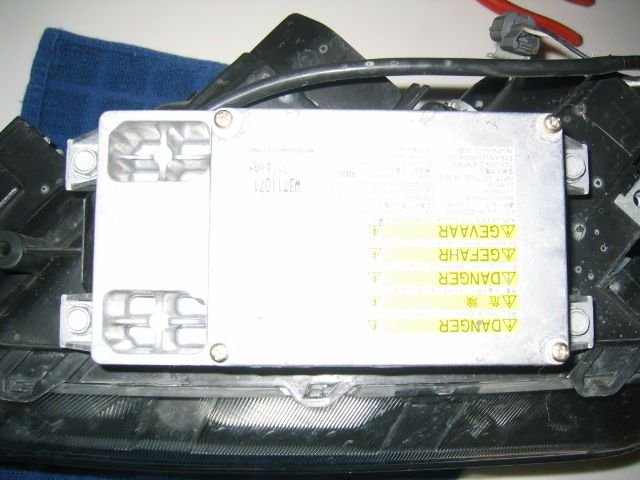

Dude that just goes around the rim of the opening. Pics up in five minutes.

Old Apr 6, 2003 | 06:31 AM
Stratocaster's Avatar
Posts: 11,399
Likes: 19
1. Remove the rubber cap over the High beam bulb (Part Number 10).
2.There is a metal clip that holds the high beam bulb in place. Release the clip and remove the bulb. Take care no to touch the bulbs with you bare hands. The oils from your skin will damage the bulb. Set bulb aside.
Security Screw Removal T25
3. Remove the "Security Torx 25" screw holding the "Danger High voltage" cover in place. If you don't have a "Security Torx 25" screw driver, just use a set of pliers to remove it.
HID Cover Removal
4. Remove the "Danger High voltage" cover. Each cover is marked with direction for Lock and Unlock.
HID Socket (Locked)
HID Socket (Unlocked)
5. HID Remove the connector for the HID bulb, by twisting counter clockwise 1/4 then pull. You will feel it release from the bulb.
Pull to Remove
6. Pull towards you to reveal the HID bulb.
HID Ground Connection
7. Locate the HID ballast ground connection. Grasp it with your fingers and pull towards you to remove. Let it drop into the headlight.
HID Bulb
8. The bulb is held in place by a metal clip. Squeeze the clip together and pull towards you.
Clip Released
9. Remove the HID bulb by pulling it straight out. Taking care not to touch the bulb with your hands. Set bulb aside.
HID Ballast
10. Remove the four screws (10mm) holding the HID ballast to the base of the headlight housing. Once the screws have been removed, slow pull the ballast away from the housing. The HID socket will have to be rotated slightly to fit through the housing to be removed; otherwise it will get caught on the HID Projector.
11. Remove the rubber gasket that seals the HID ballast to the housing. (Part Number 7). It may be stuck in the groove in the headlight, or connected to the ballast. This gasket is the key to stop the headlights from condensing water. Set aside.
12. To put the back together, do those steps in reverse.

do youhave a picture of the gasket by any chance?? and how it inserts in there? cause the gasket i recieved is padded on one side with double sided tape....i dont know if it faces inward or outward...
