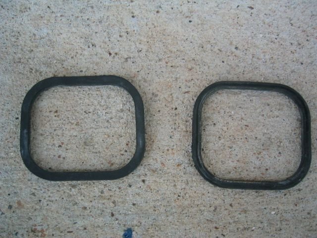

Originally posted by DavidKang
do youhave a picture of the gasket by any chance?? and how it inserts in there? cause the gasket i recieved is padded on one side with double sided tape....i dont know if it faces inward or outward...
Here is a set of used gaskets (face up, the other face down).
The groove seen in the one on the right fits on the lip of the ballast. The smooth side (on the left) against the headligh assy.

perfect...you are awesome man.... how come your name doesnt show up on the online list? anyways....can you pm me your shiipiing address and what you want....cause a deals a deal and ill send it out tommorow...

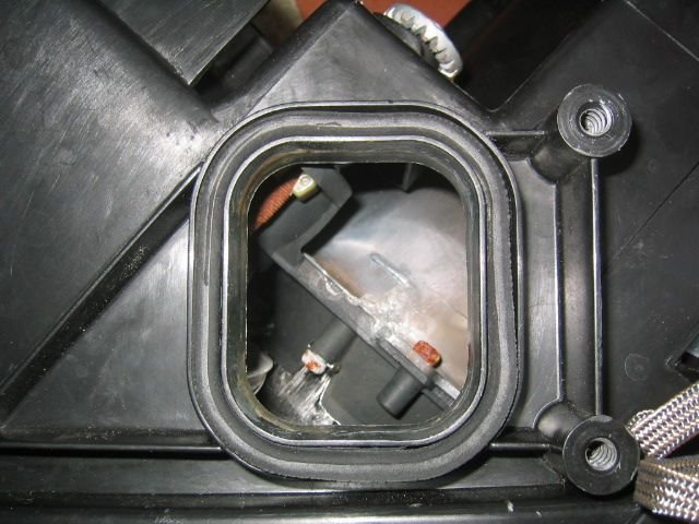

Here is pic of the gasket installed in the Headlight housing.
