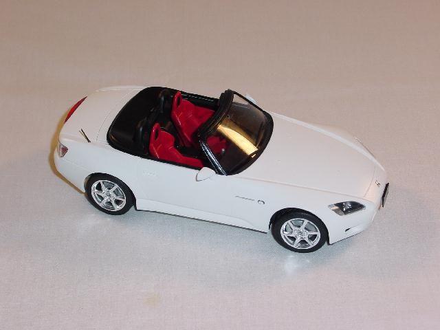

I have been building models for years and have built the first and second versions of the kit. The first version featured a convertible top with right-hand steering only. The second kit included the hard-top and the left-hand steering arrangement.
For glue, I use a combination of super glue (cyanoacrylate - CA) and Elmer's white glue. The CA is used for glueing every part EXCEPT the clear parts. The white glue, applied with a piece of tiny brass rod, is used to attach the clear parts to the car since it dries clear.
The Tamiya kits are really nice, especially since they include die-cut painting masks for the front and rear windows. However, if you look really close, there are mold seams on the front fenders and the rear bumpers that depending on your discriminating tastes need to be removed. Being somewhat of a picky model builder, I removed these by sanding them off. As a result, I had to repaint the entire body. If you are painting it white, my advice is to put down a primer coat of a light grey (Testor's Light Aircraft Grey for example) then put on thin layers of white. Air brushing most always produces a clean finish but spray painting can also yield good results.

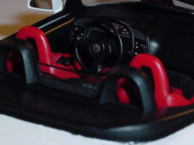

Below is my white S2000 model (the second kit version that has a left-hand drive). I airbrushed the body white and all of the black parts. I used Testors Red in a spray can for the interior. Before I installed the mirrors, clear parts, emblems, and headlights, I put several coats of Testors Gloss to give it a good shine. The interior details were painted using fine-tipped brushes and toothpicks (for the really small details).
Enjoy.
