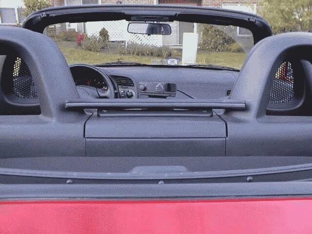

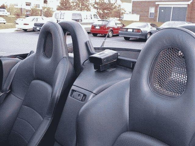

Taking a hint from a few posts on http://www.nsxprime.com, I tapped into the cigarette lighter lead and mounted the V1 between the roll hoops. It's mounted w/ velcro and I used a Radio Shack-supplied prototyping box to raise it sufficiently above the wind deflector frame.
This is done because I live in the wonderful Commonwealth of Virginia and it makes the unit damn near impossible to notice from most any angle.

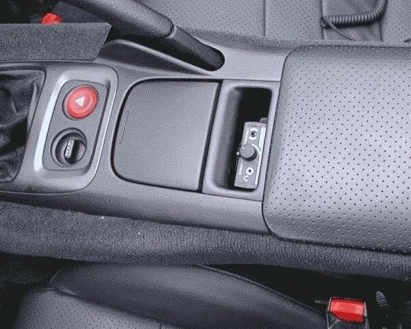

I then ran the phone cord down thru the console to the T-adapter, and placed the remote audio adapter in the cubby directly behind the cup holder.
The remote audio adapter can control power, volume, mute threshold, and mode. It includes its own speaker as well as a headphone jack. It's meant mainly for cycle installations, but since I cannot easily access the volume control on the main unit (since it's above and behind my shoulder), it really makes the install. I simply turn off the volume on the main unit and rely on the loud emitter on the remote unit.

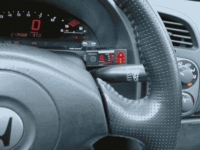

I then continued to run phone cord from the audio adapter down the center console, under the behind the plastic plate that flanks the stereo, up under the dash, and then up the steering column.
I then used velcro to mount the remote display adapter just above the wiper stalk (it's now mounted slightly higher than in the above pic). I don't use the mute/mode button on the display, but rather the one on the remote audio adapter. I find it very convenient to just slide my hand off of the shift knob and down to it's large knob (it's the same size as the one on the main V1 unit).
Finally, I covered the entire display of the main unit w/ electrical tape.
This was done because even w/ the remote display adapter, the main unit will light its display during power-up tests.
I have been very pleased with this install. It appears to be invisible to the police, does not take a large chunk of my windshield, and does not appear in my rear-view mirror.
