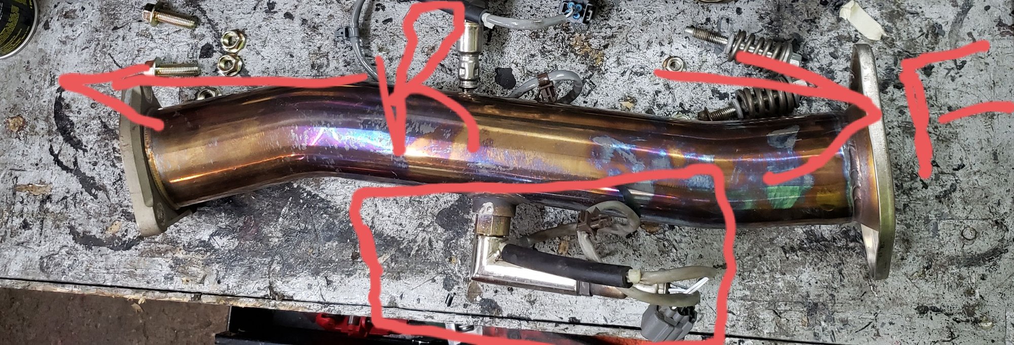

https://www.walmart.com/ip/Car-Sensor-Angled-Extender-Spacer-90-Degree-02-Bung-Extension-M18-X-1-5-For-Any-Thread-Size-Of-18mm/329256930
They come as a kit with straight, long, short, and angled peices. Here's rhe orientation I use with a test pipe on my MY07 track car. No CEL for me on my stock ECU. So it should work just fine with your HFC.
This orientation was recommended by Billman.

Than you sir! So the Walmart one you linked is straight plug and play? (Simply take off the O2 sensor then screw in the right angle spacer then screw in the O2 sensor into the longer end of the spacer?)
is it ok also for your O2 sensor cables to be twisted up like how it’s shown in your photo when re-installing?

Yes, just orient it like I have it and screw it in/tighten it.
The cable is just bunched up because I put it down that way.
Remember what I said about completely unplugging and unclipping the O2 harness from the car.
Take note or mark or take photos of where it clips into.
Then install everything.
Then clip the O2 harness back how you found it and plug it back in.
It should clip to the trans mount, and again to the trans bracket before winding its way above the trans, and clipping once more into a bracket where the plug is.
