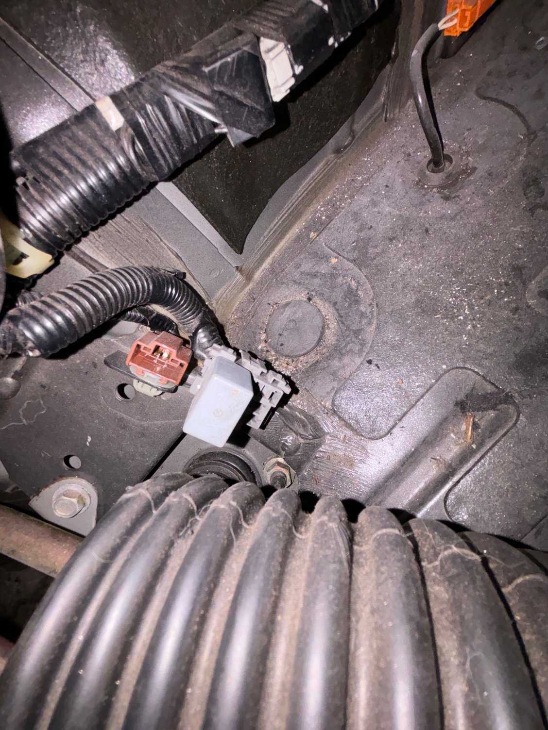

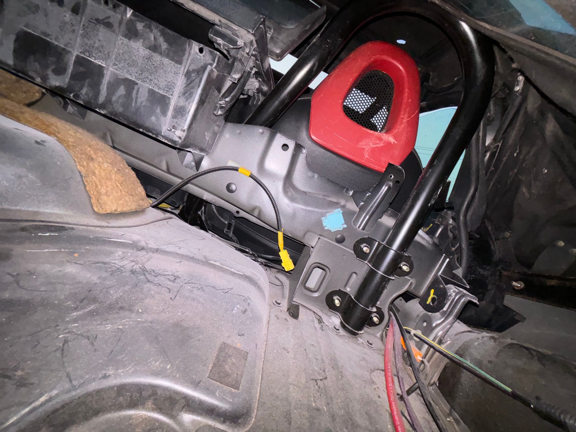

Hey guys just bought a super chopped up S2K and am trying to figure out what it needs. Have some plugs that are unplugged and don’t know what they lead to, any clues? Thanks!

if you google "s2000 ETM" you can find the electrical manual. yellow tape means airbag. the middle 2 pin is the trunk release button.

Yep in general on modern cars, yellow connectors and yellow tape mean it is part of the SRS/airbag system
and that you should 100% probe them with the battery connected and with a generic test light.

Thank you! Any ideas on the unplugged burgundy female connector?

I think the burgundy one is the rear defroster?
What year is your car?
Its a 2001

I am pretty sure I saw the same connector on my friends AP1 when we removed the soft top assembly but never looked it up because we didnt care at the time (going hardtop and it is a track car). But am not 100% on that one. I know there was a connector we saw and thought "hmm wonder what that is for" and then just moved on with what we were doing.
