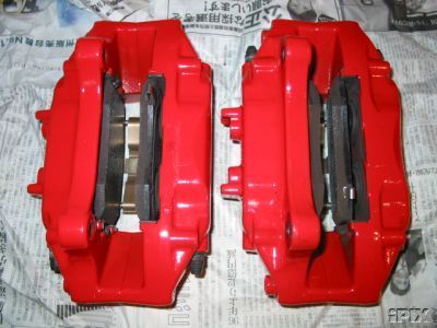

Does anyone know if the calipers from a Japanese Honda Integra (DC5) fit on a S2000.

They will bolt on, but you will need to make a custom rotor to make them fit. The offset on the rotor is sllightly different between the two cars resulting in the need for a small spacer once you get it to work

To be honest with you, I dont think its worth the effort. If memory serves me right, that is Brembo's Lotus caliper. Basically, its just a 4 pot CAST caliper, pretty heavy. With a pretty name of course
Even though you could probably find the calipers for under $500, the rotors would cost you even more. I strongly believe there is a very good reason why these did not make there way on to the S, I just wish i new what it was.

Thanks for the info, I was just trying to find a lesser priced caliper than the others brands.
