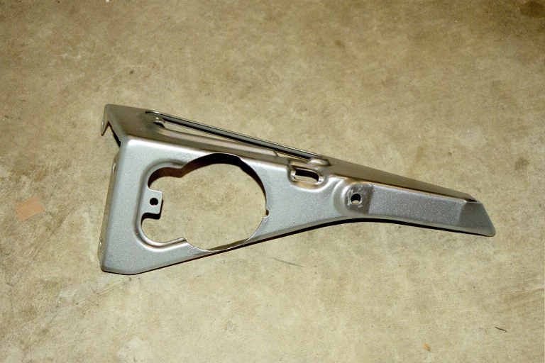

Below is the black plastic support, which I used the 3 1/4 hole saw to cut a hole.

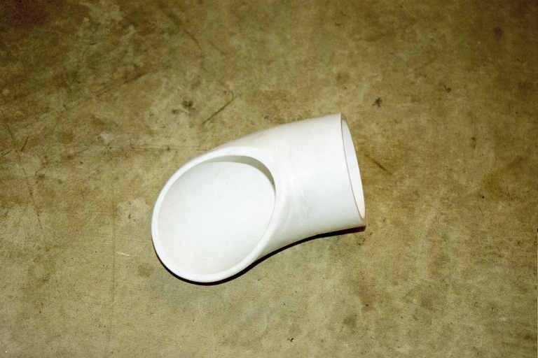

The white PVC pipe is a 3" street 90, which I sawed off the coupling end at a 45 degree angle.

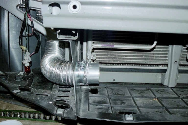

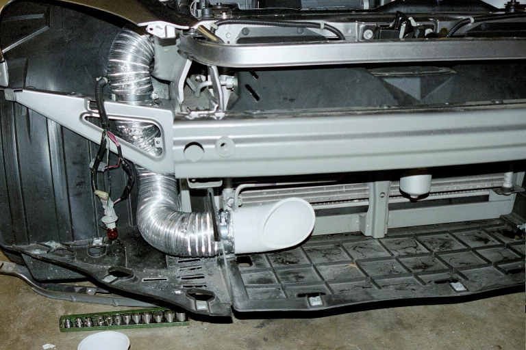

The aluminum duct is a 3" flexible line used for dryers. I cut the aluminum duct and used aluminum connectors between the headlight brace and the black support. I like to test the system with an air temperature gauge to see if there is any improvement.

just one little concern, it might actually lose some power, since when vtec engages the s2000 sucks up a bigger amount of air ...
since the hose has a lot of twists, snaked through the back of the bumper- it might create a tiny amount of vacuum "gap" when vtec.
i might be totally wrong, so correct me if i am.
otherwise, good job! looks real good/ nice workmanship!

Seung, thanks for the complement. I did not make the air duct the only air the CompTech air box will receive. I stopped the air duct just at the opening on the fender, so I hope this just provides additional cooler air?
I also, painted the PVC pipe black to hide as most of it from view.
