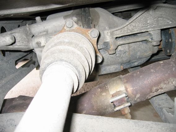

Here is your outer CV boot on the rear half shaft (don't forget the other side):

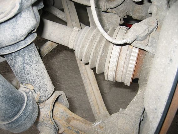

Here is your inner CV boot:

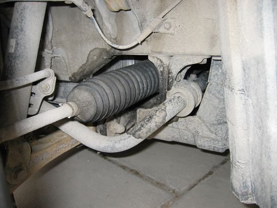

Here is your steering rod boot (there is one on the other side, too):
Take your silicone and spray the heck out of each one of these boots. Get them soaking wet and dripping. Try to avoid the brake area.

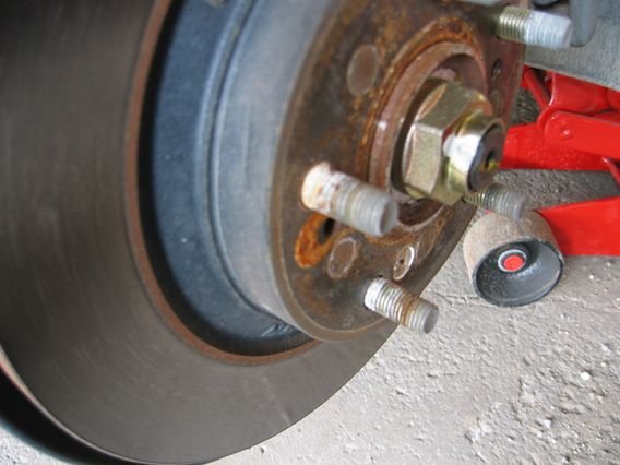

Notice on mine how they tend to get debris built up and some rusting has started. This is more apparent on aftermarket lug nuts as the stock ones are closed ended and keep the crap out better:

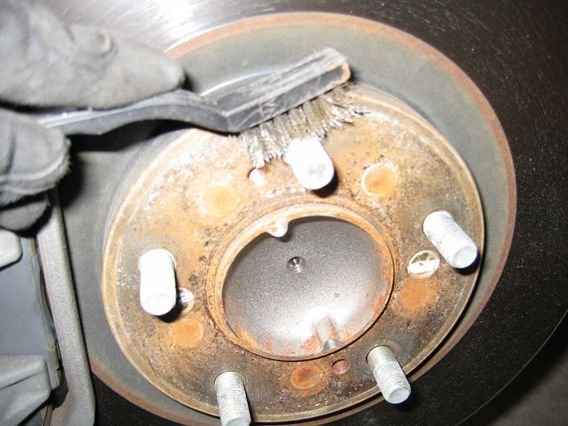

Take a small wire brush and go over each lug threads:
If it's handy, spray a small amount of WD-40 (not a lot and avoid the brake area) on each lug, give the excess a wipe and put the wheel back on.
