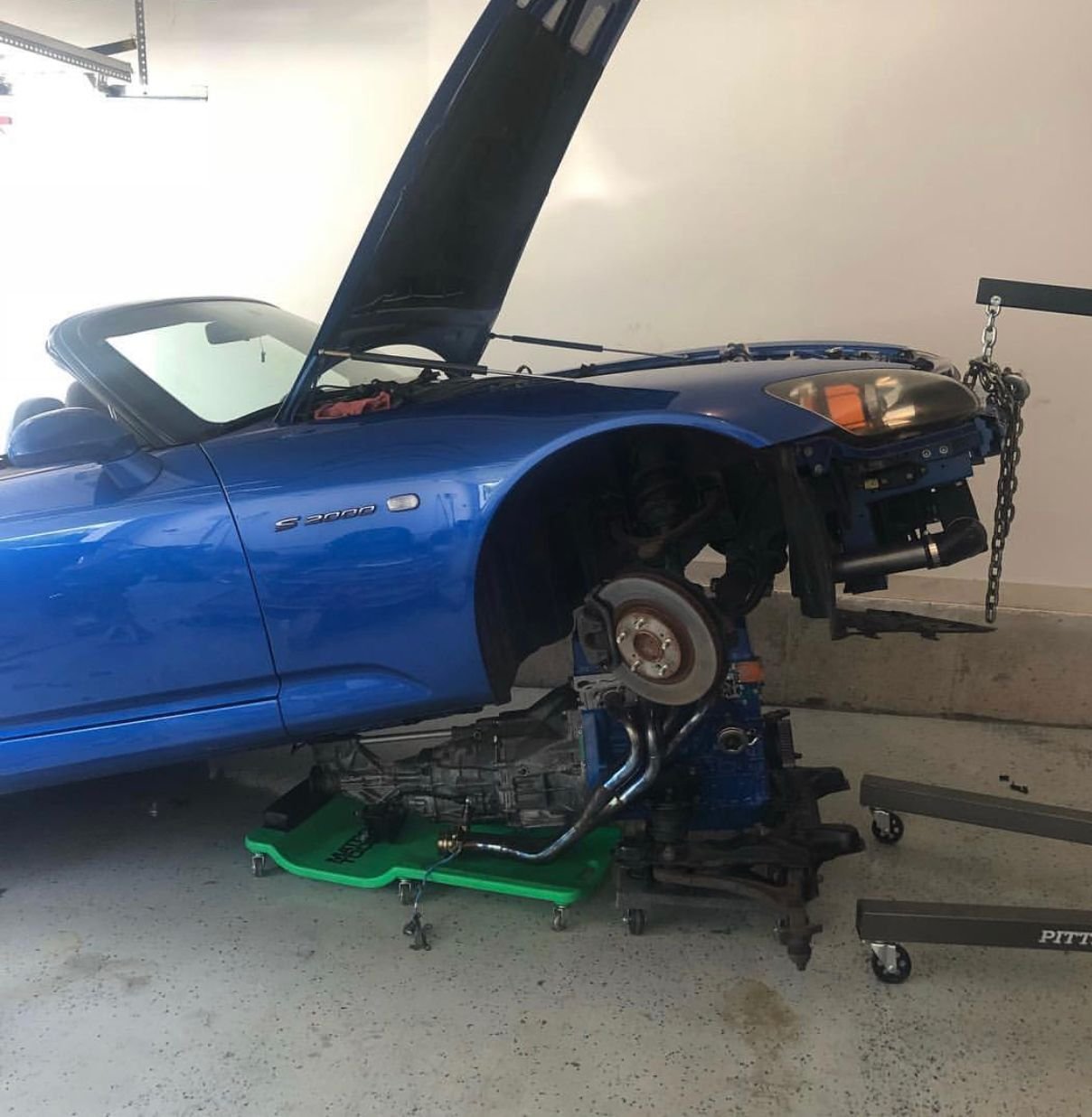

I have swap out the engine many time all by my self in my garage at home with no lift. I first pull the transmission then pull the long block out from the top with a standard cherry picker.
Old Jul 21, 2019 | 12:27 PM
outeiroj's Avatar
Joined: Jan 2010
Posts: 349
Likes: 34
i pull the front bumper, set up the front cross member on jack stands... then pick up the vehicle with the cherry picker from the front bumper support. then using a jack I drop the subframe onto 2 furniture dolly's and roll out the entire subframe.. engine/tranny out within 1.5 hours
