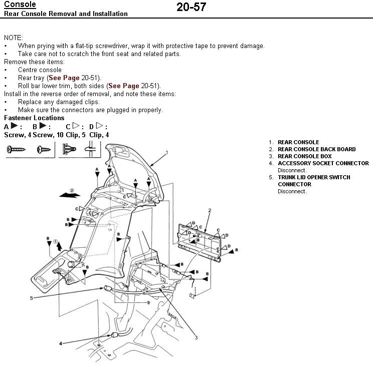

I need to see how hard it is to remove these and at some time I read a thread that had a diagram of them.
Only problem is I can't seem to find it, anyone have the diagram or link? If you have any suggestions/pics on removing these it would be great also.
Thanks
Paul

I am wondering if I can't get the hoop covers out if the glove box/ secret comp can be removed?

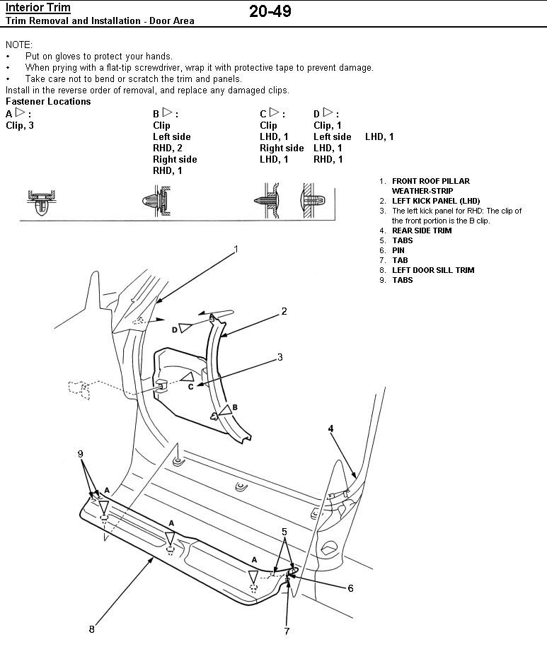

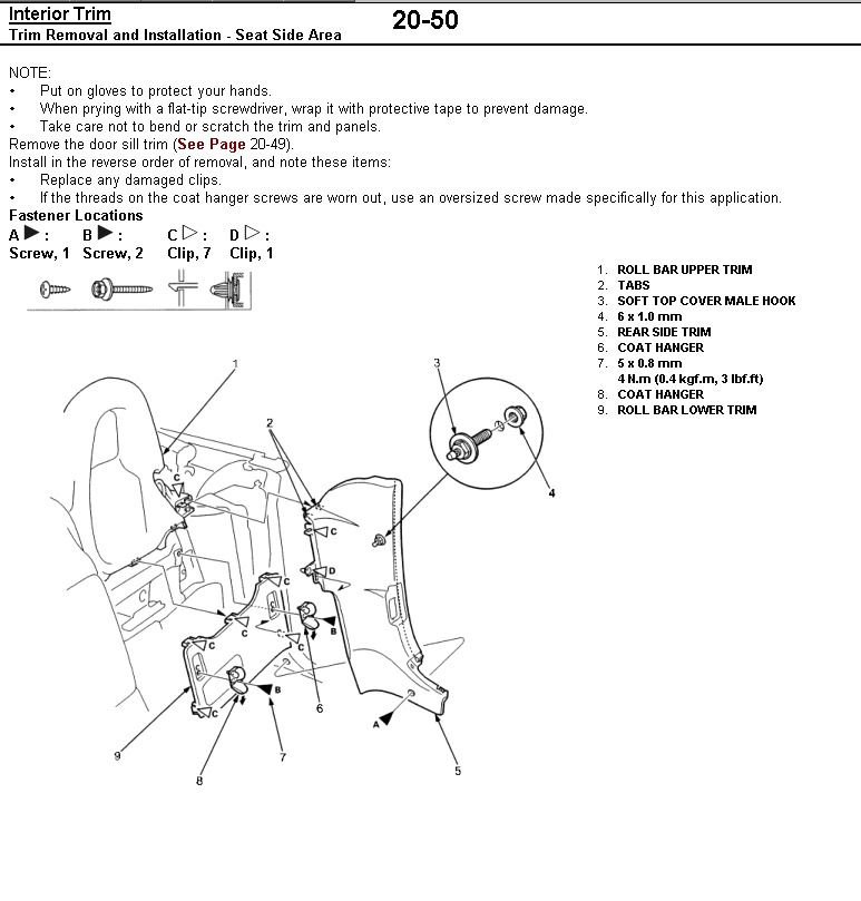

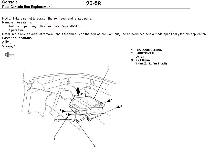

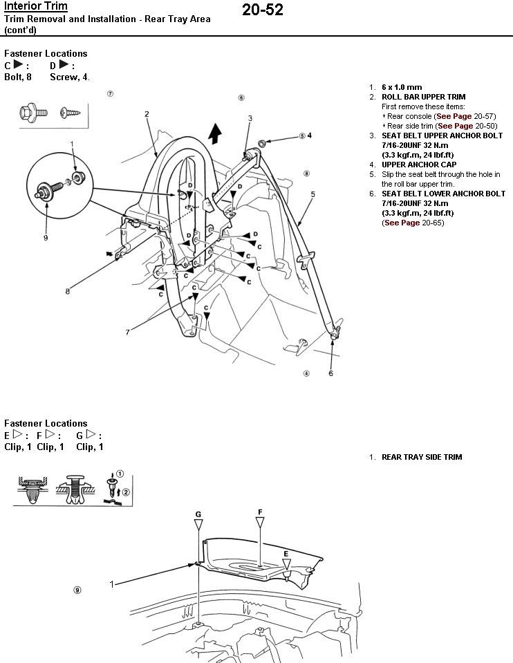

Old Oct 14, 2003 | 11:27 PM
3ngin33r1's Avatar
Posts: 16,231
From: Kingston, WA
Hope that helps.

Thank YOU 3ngin33r1!
Yes it does help! Looks like I need to do battle with some clips
