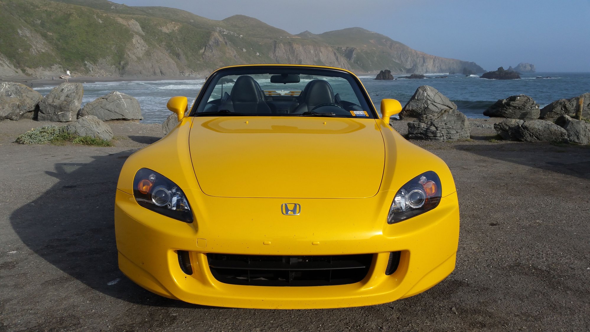

Looks better without it IMO. A heatgun can help. A number of threads on it. Last few years Honda stopped putting it on.
Here it is without it on my 2009.

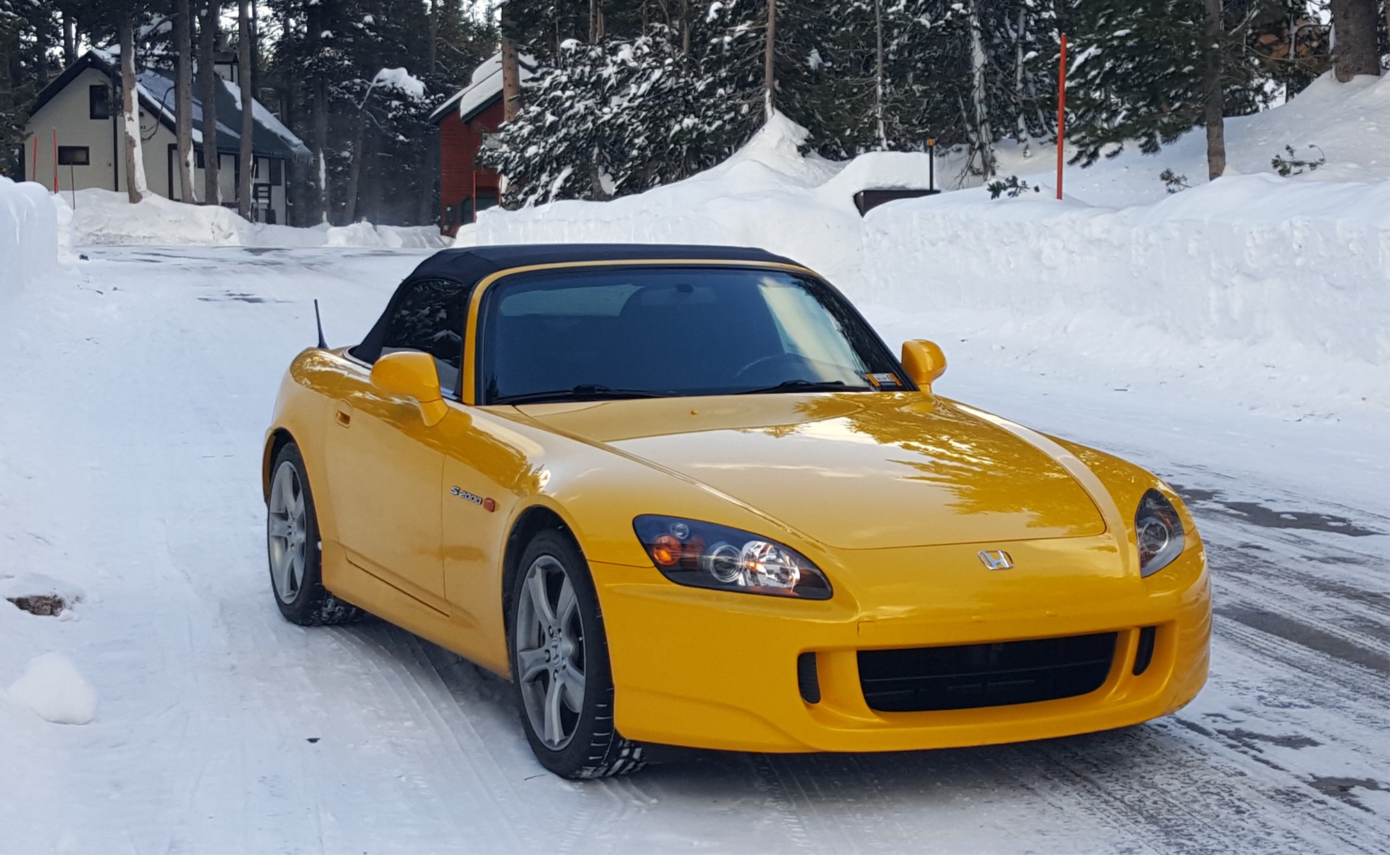

Originally Posted by wirebrat
In the pictures I've seen, it looks great with the top off (nice look, cosmomiller!) but to me not as good with the top up.
Here yah go, top up:
