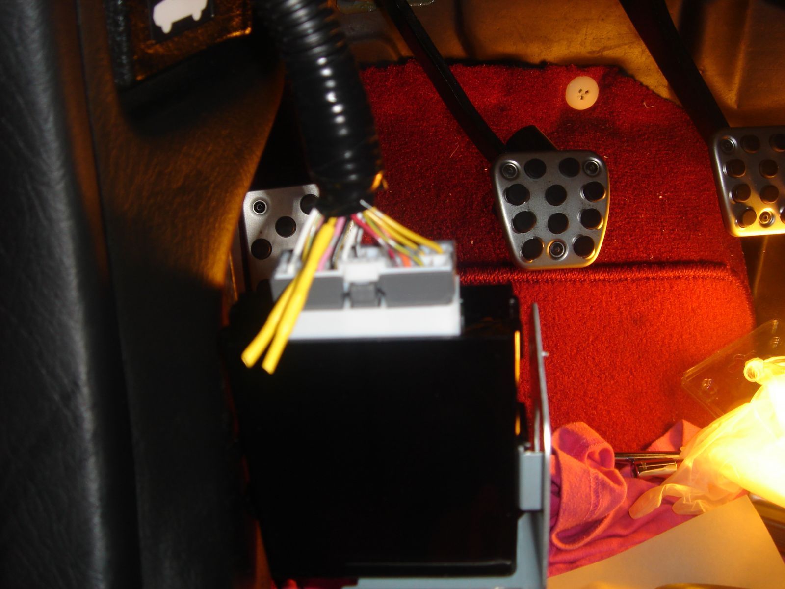

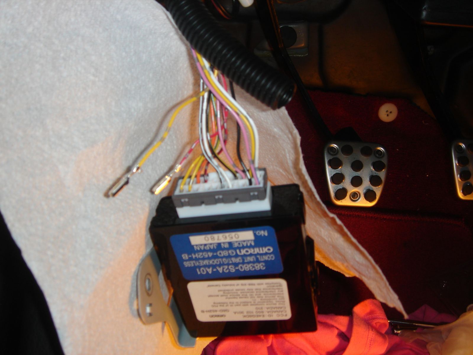

Here is the real picture, I first used socket #10 to remove the whole module(easier for me), or you can unplug it from the module.
Plug location behind the START button( finished)
Wire # 13(Red/White), #16 (yellow) pulled out/ or cut out
Wire tube heat shrink the plug end(Yellow)
Wrap it back on and bolt it back on
WORKS WELL.

not sure why you had to unbolt it.
i just hit the tab and pulled the connector out.
made the cuts and snapped it back on.

Jason?? Yeah I unbolted, because its hard try to pulll it out, I was afraid some wires snap while try to pull it out, just a cautious on my side.
