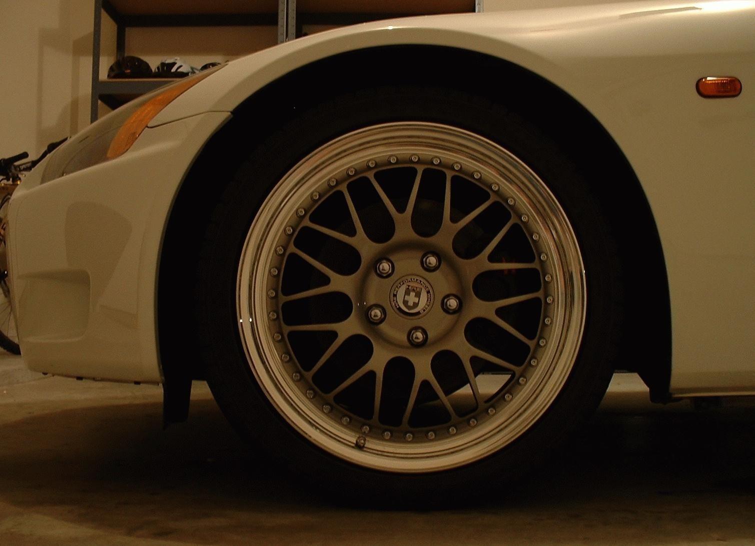

I have the HRE 18"x8.5" in the front w/ 245/35/18 P-Zero and 18"x10.5" in the rear w/ 285/30/18 and the ride is somewhat harder, but not enough to be bothersome. The extra meat on the road is nice too!

I also have HRE's. 18x8.5 with 225/40s front and 18x9.5 and 265/35s rear. I have noticed a little difference in ride quality but I think the increased grip and aesthetic improvement is worth it. Like others have said, I try to avoid hitting road reflectors when making land changes and spend more time dodging pot holes. You won't have as much rubber protecting your wheels so you have to be more carefull around potholes and curbs.
If your going to do it, I'd really suggest the HRE's. They are true three piece forged wheels (read: much less likely to bend than lesser cast wheels). The Bulletproof 9.5 and 10.5 inch setup is nice, but you may want to talk to Ben about the sizes I have in case you are thinking of lowering.
