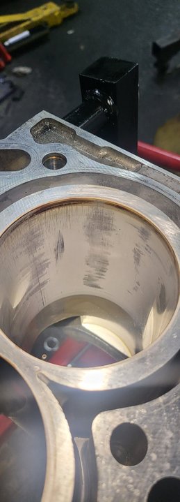

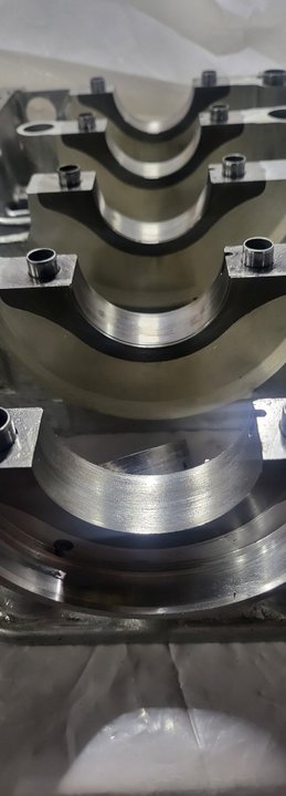

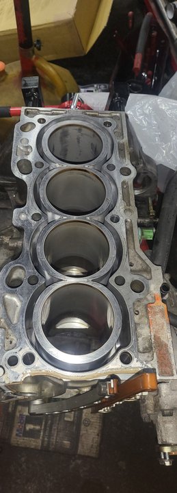

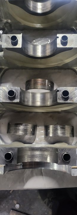

My 2004 AP2 motor went due to leaking oil from the rear main seal and me being careless.
I'm reaching out to see anyone here has a bare f22c block available. I really don't want to make this a Want to Buy thread, especially since I'm considered new, but I also want to absorb all the information anyone is willing to share for the situation I'm in.
I have already purchased a new oem crankshaft and bearings before tearing the motor apart and actually seeing the extent of the damage. Assuming I only need a lower block, I've read I can use a f20c lower block with a f22c crankshaft. If this is true, do I purchase AP1 rods and pistons? (with AP2 piston rings?) Would I need to tune my AP2 to AP1 if I went this route? (AP2 head with AP1 block and f22c crankshaft) Would I need anything else?
I'm considering on what to do from the options I had before coming here. I do not know any reputable local machine shops (I'm located in Flushing, NYC). Before I make a table out my block, I'm assuming it is not salvageable. Cylinder 4's wall needs a hone (from what I read about our FRM walls, mine looks to be trashed) and the girdle portion of the lower block where the spun main bearing sat has been grinded down. There is no way it can be machined to spec from this point, correct? Would Inline Pro accept my block and girdle as a core to be sleeved if I went this route?
Long story short, I need a f22c bare block with no cylinder wall damage. I would buy a complete used f22c (for a decent price) or even do a k swap, but I've already sank $ into a new oem crank, oem bearings and complete oem gasket and seal kit and tore the motor apart myself. I want to rebuild her.

My advice, first, sell the crank you bought and all the other parts you aquired.
Second, if planning less than around 475 whp, buy a good running used f22, don't open it, add your fi.
Or if going for more than 475 whp, k swap, add the fi.
