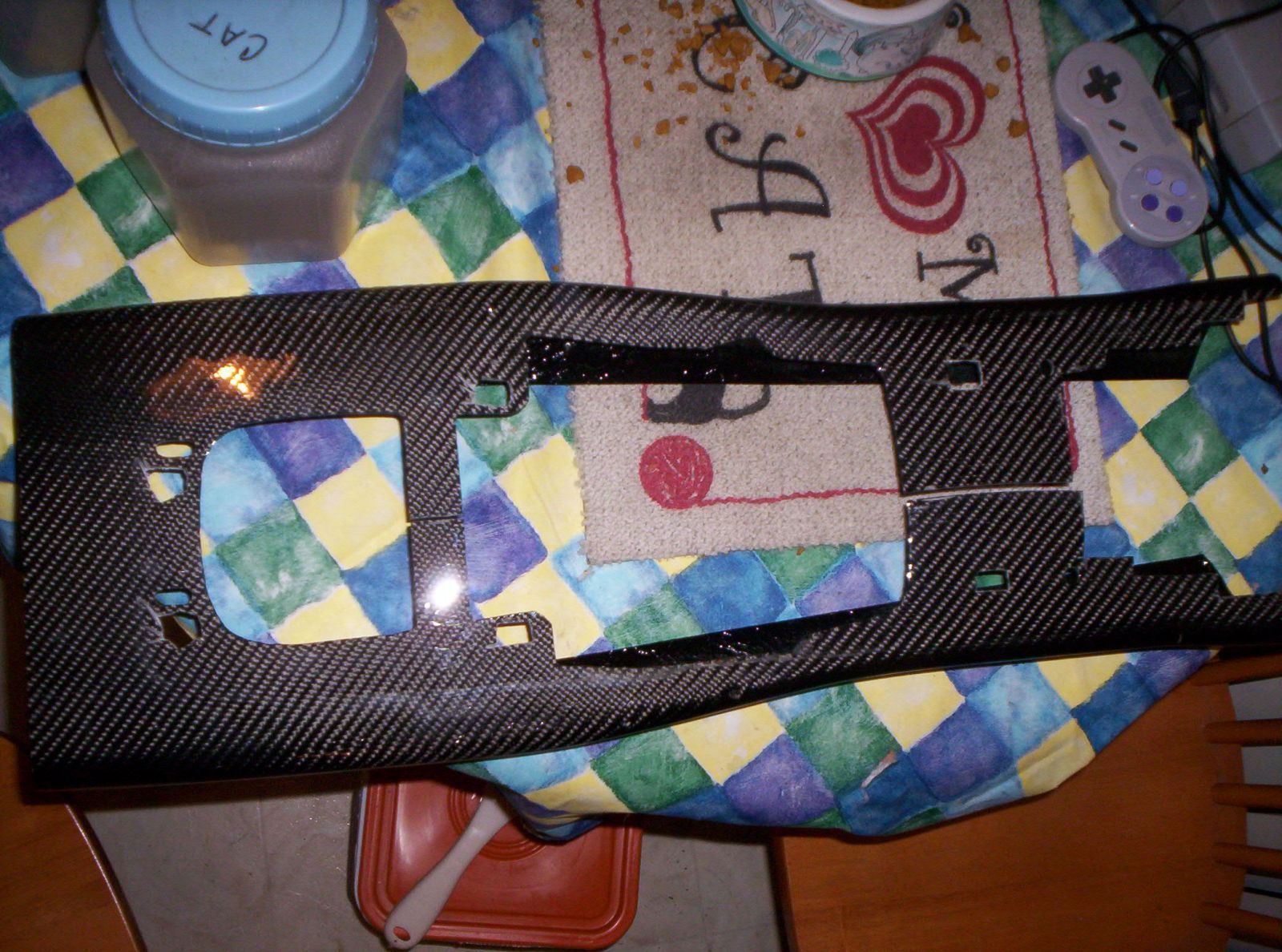

I left mine in tack, and did not cut any pieces. I think it was recommended you start from the radio door and move backwards if i remember correctly. Just bend/peel back the bottom edges slowly and as soon as you get it wrapping around, it's all down hill from there. And yes, you'll need to remove the carpet.

Posts: 9,769
Originally Posted by S2-3456789-K,Feb 16 2008, 03:48 PM
when you say that you cut it down the middle, did you cut it complete in 2 pieces, or did you leave the radio door side intact (the part that's exposed after you put on the console)?
I left the radio door side intact. I didnt cut it into 2 pieces. You can see in these pics where I cut it twice. If I would of removed the carpet to begin with I wouldnt of had to cut anything!
