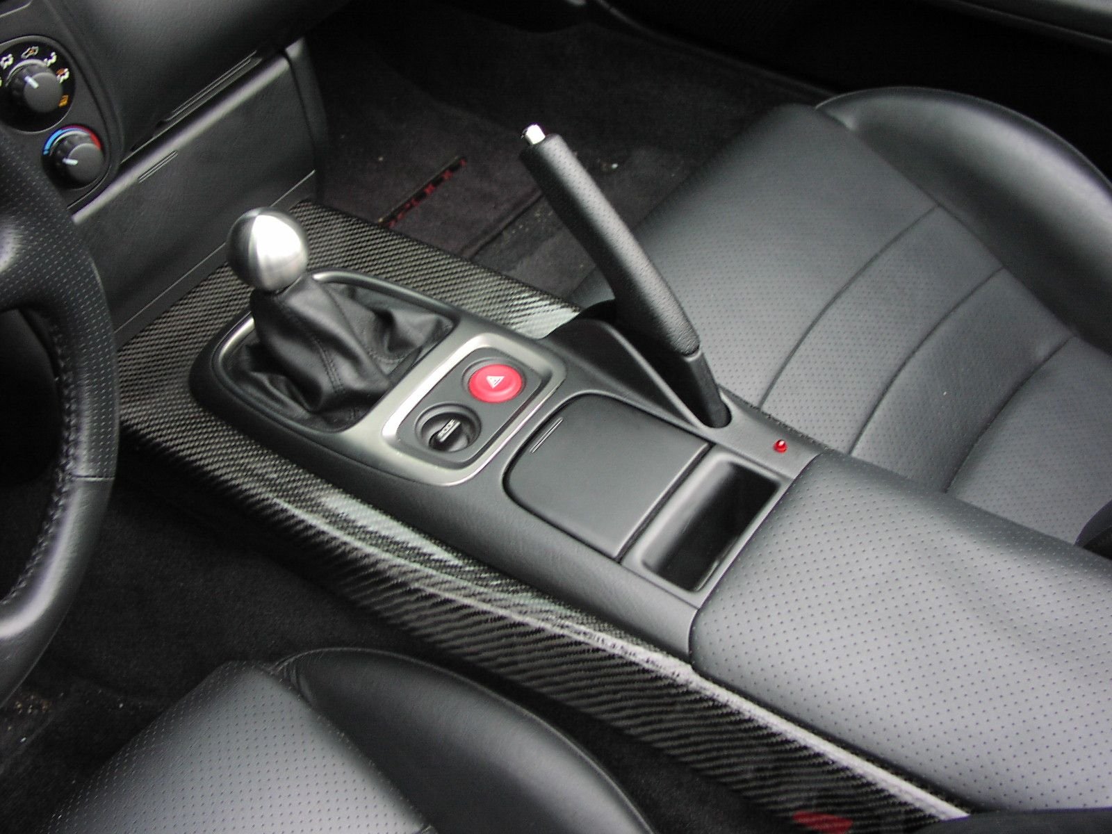

UPDATE: just put it on this weekend. I decided to make the cuts suggested by NFRAP1, and it literally turned an impossible task into a 5 minute job. My center console piece is slightly different from the one pictured in NFRAP1's post. The rear end (or the end closest to the rear console) fits under the rear console, so the rear console had to be removed (or at least loosened). Having made the cuts, I was able to slide both sides in separately. When it's all said and done, the cuts are undetectable.

These instructions are very good. After trying to make it fit for a while, I figured I had to either cut it, or remove at least one seat and loosen the rear console. I just took the easy way haha. Honestly, after cutting it, it took 5 minutes.

fitment is pretty good. after cutting it, it was very easy to put on.

.... sorry to revive a super dead thread... BEST WAY (just finished doing it) is to take out the leather that covers the bare metal. and then install it.. no cutting to the cf center peice needed.
