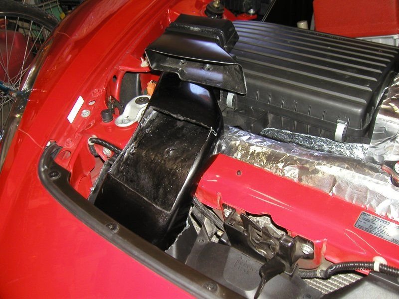

I just got a spoon type snorkle put in be4 my trip to L.A. where I knew I would be in alot of stop and go traffic. I had experienced first hand the heat hesitation that these cars have a weakness towards and was educated in another thread about some heat studies that another member posted a few years back. After insulating and snorkleing, I was unhappy with the restrictive airflow of the snorkle (one half inch by 5 inch across as it dives down in front of the radiator) that I cut out the top panel of the snorkle to relieve this restriction.
I have been in L.A. for the past week in 100 degree temps and have experienced no dead spots even on steep stop and go starts.
It's not the prettiest engine but that will come as come across the cover meshes.
I am very thankful to all the wonderful posters who have done all the leg work in this forum to help us newbies out!
