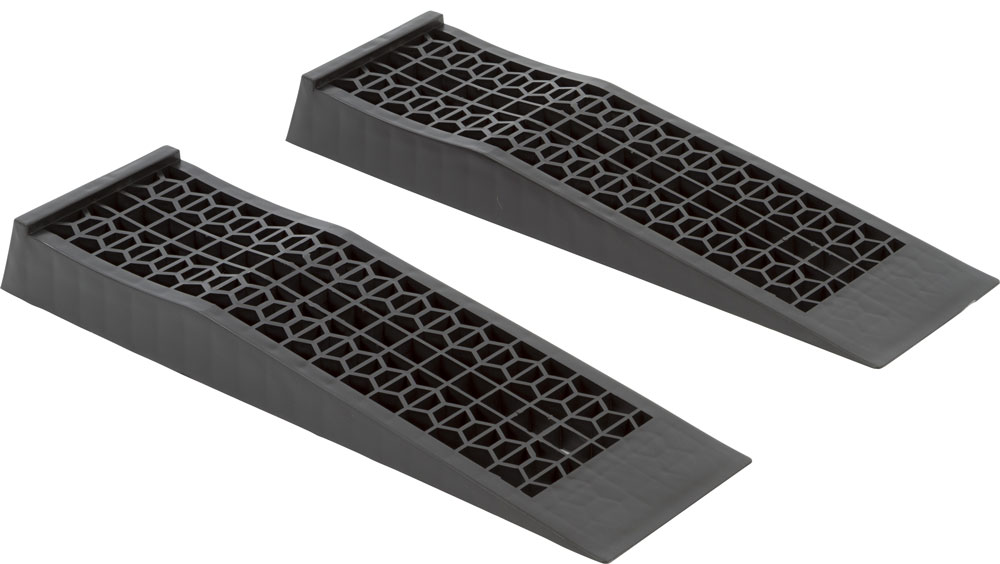

I use Low profile Mini Ramps.

Sometimes I'll back the car onto rhino ramps, then jack up one side on the front to roughly level it. The car can only clear the ramps in reverse, so this is the quickest way to get it up for fluid changes.

Drive it up into a couple 2x4's and jack from the mid point on the front, or diff from the rear.

I use Race Ramps Trak-jax ramps so I can get directly to the front jacking point. One of the best $100 I've spent because I needed them for my STi as well.
