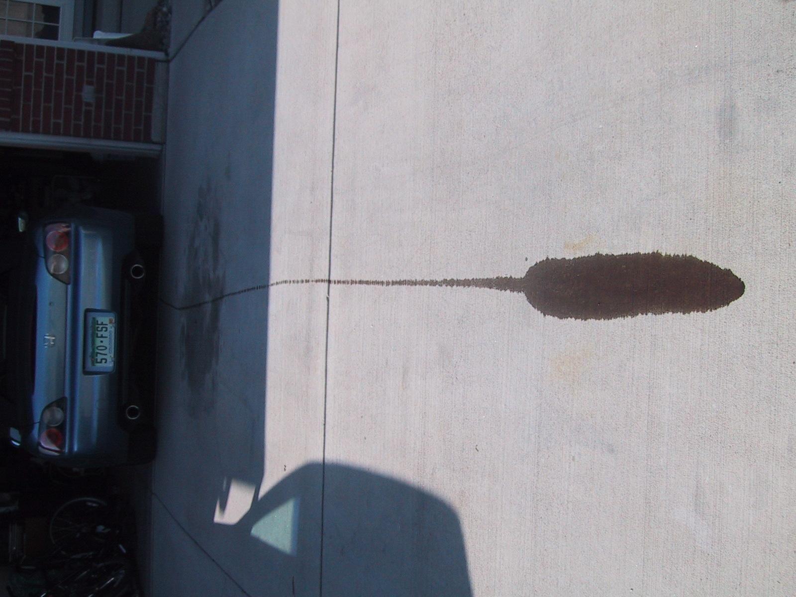

I pulled the car out of the garage, took the pic of the door and looked back towards the garage
The upper part of this picture is what I saw!!! imagine the S2000 covering the right portion.

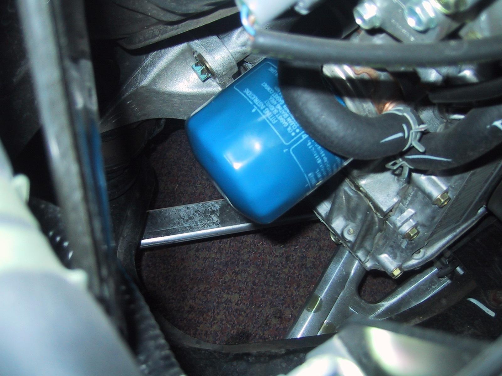

YEP, its OIL and its coming from the loose filter...
Pic of the filter, spots of oil and drips below on the garage mat/carpet.
The oil only dripped when the engine was ON! and it left only a very small spot where I had parked in the garage. I tighted the oil filter (filter could be easily turned and needed to be rotated at least 1/2 a turn).
Then the part I dreaded...checking the oil level....
It was RIGHT AT FULLLLLLLLL!!!!!!! JOY HAPPINESS HEAVENS OPEN
If I had not taken the picture I might have drove all the way to work ~16 miles....I'd rather not think about that!
