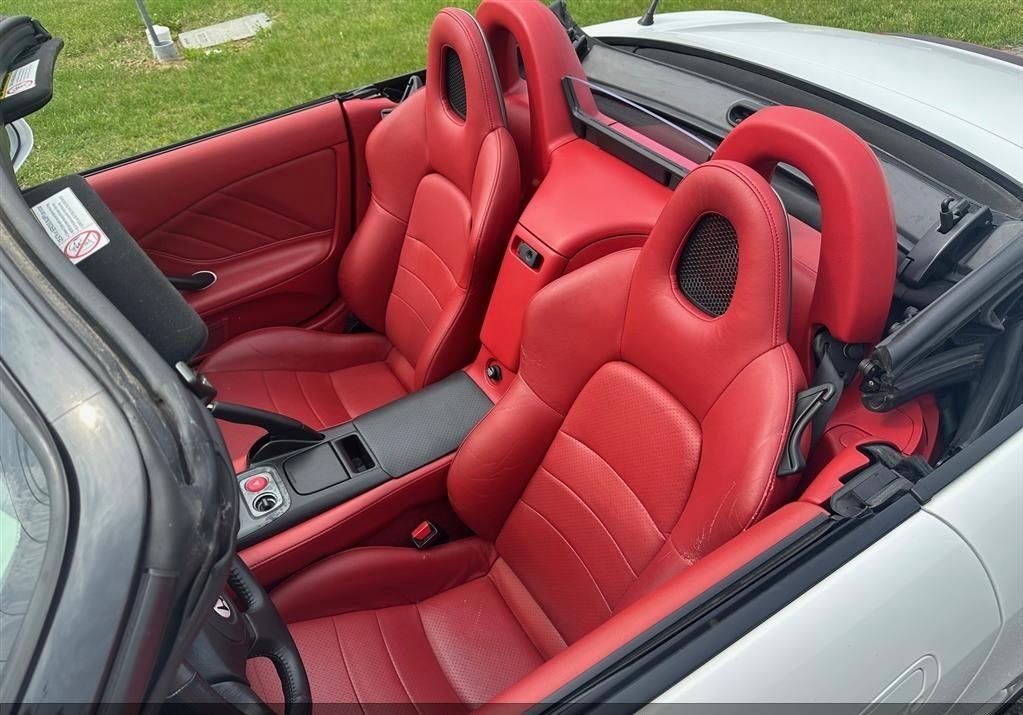

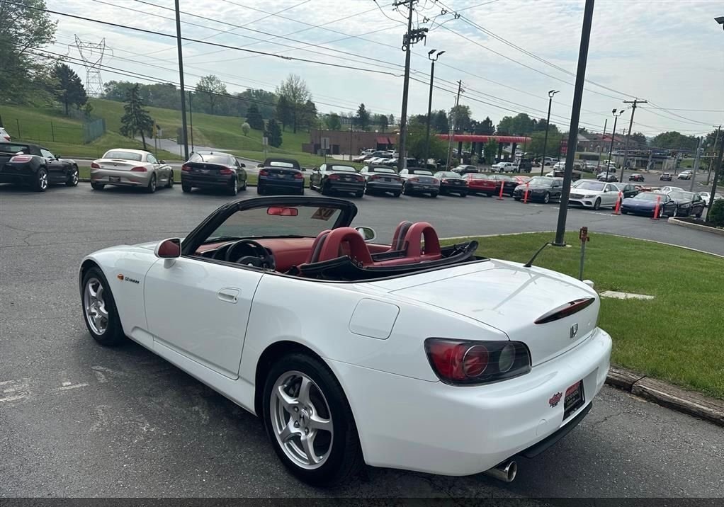

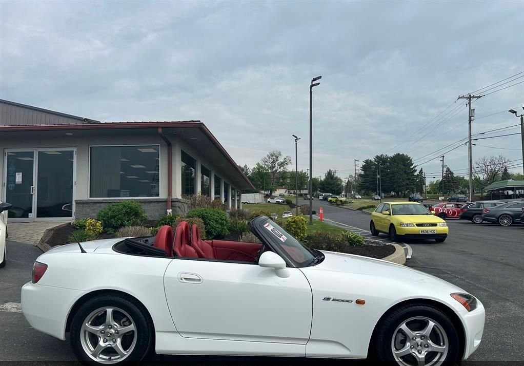

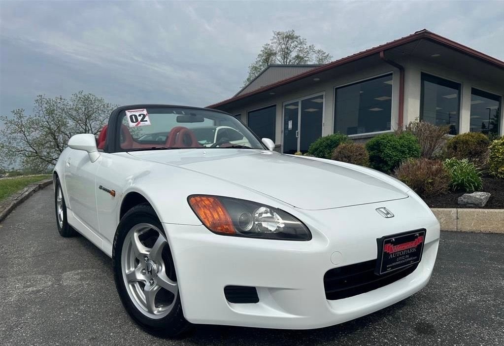

It looks like such a clean car besides this.. exterior and interior both super clean. I’ll get a video of the underside on the lift on Monday to help me decide. The top looks to be in great shape. There’s not even curb rash on the wheels.

I like the interior it does look clean, outside body is clean and wheels are perfect. I think it was well kept by the previous owners but underside rust is hard to avoid if driven in winter or near an ocean. It would not keep me from buying it, but again I am not familiar with pricing in the USA. The interior shift surround needs repair (but many seem to do that) , easy fix to remove and paint silver. The engine bay needs a major cleaning, and I would have to replace the valve cover, no way I could keep it looking like that. Again not the owner's fault as the valve covers do peel over time. I would have the underside rust proofed - black woolwax would work wonders. Make them a lower offer , that car needs about $2k of work from what we can see. Obviously we have no ideal how the mechanicals are on that car or the maintenance history, miles are nice and low. Good luck.

The low miles and clean exterior and interior are all most buyers ever look at or care about. So from a dealers perspective, thus is a cream puff. One of the best examples.
