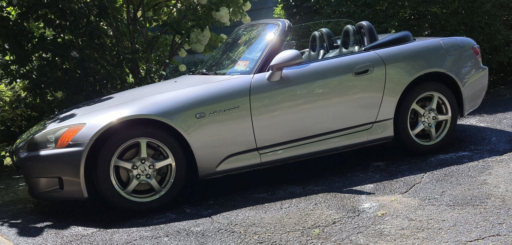

It looks like it sat outside, near the ocean. IF the dealer is willing, have the entire underside dry ice blasted. It will remove ALL rust, and then you'll see what the car really looks like.
The only concern are brake and fuel lines. They are a pita to replace and if you aren't able to do it yourself, it's expensive.
My '03 was a dd for a senior during spring, summer and fall in South Jersey (Bridgeton) before I bought it. The car was, well, dirty and ugly but I saw through the ugly. The car has very little surface rust anywhere on the car. I pulled the taillights (a great area for rot) and there's a couple of places I had to treat and prime I took this pic yesterday. I have to polish up the headlights again. (about every 3 months) I've had it since Oct 27, 2012. Two days later the garage it was stored in down there was under 8 feet of water from Sandy. The left rear looks high because the right front is in the drainage swale in my driveway.
